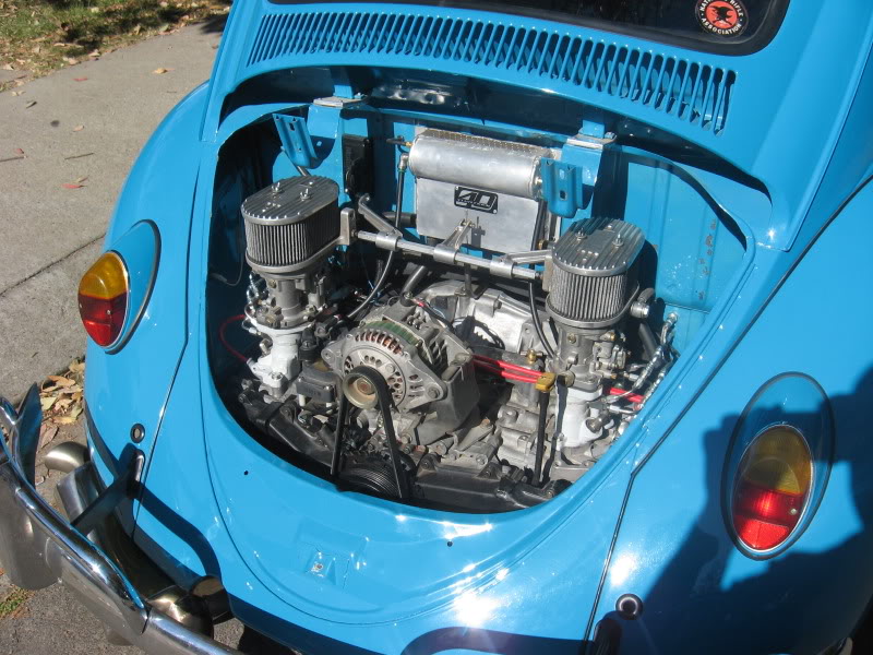

Or why anyone would WANT to:

I would quickly step up to that challenge.
I wonder how well they run off just webers....
If I go this subaru way (Mike) I am going turbo....I dont see any fun in not doing a turbo....

Even if it's a -6?
