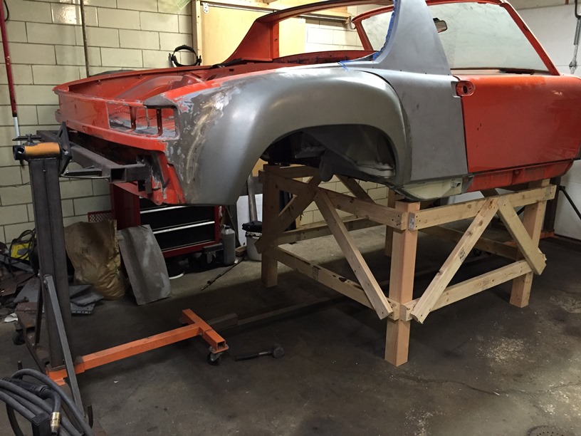

I am making some more progress and will hopefully be taking the 914 to get media blasted in the near future. My son said he could transport it to the blaster but not when it was so high on the rotisserie.

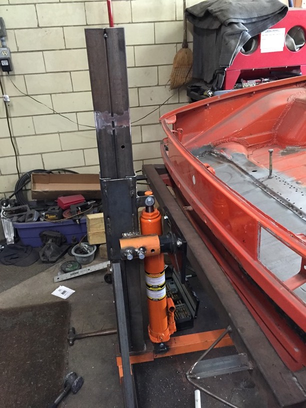

I built a wooden frame under it to support it while I redid the rotisserie ends to allow it to be lowered.
Do I get extra points for the highest homemade jack stand?

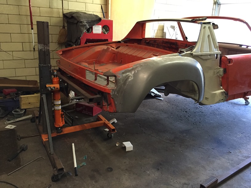

Anyway after some significant cutting and welding to the rotisserie I ended up with the modifications below.
Now I am able to lower my 914 to transport it and then raise it back up to media blast the bottom of the car. As most everything we do this modification took me longer than anticipated but now I can get back to finishing the metal work up.
