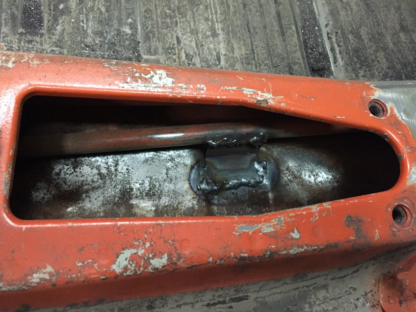

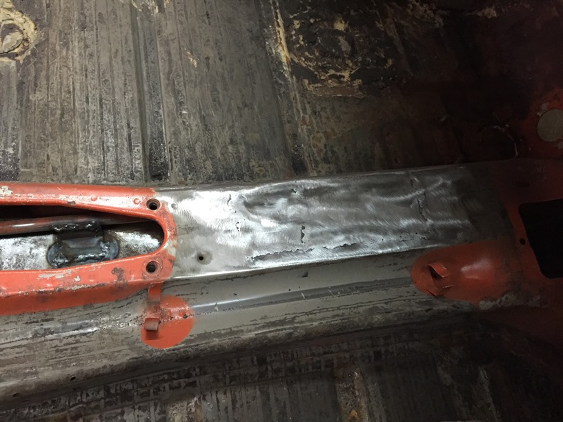

I finished up the clutch tube repair and closed up the hole.
Then I added an additional support just to make sure it doesn’t flex.

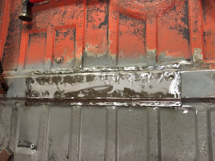

Last night I finished welding the trunk support plate in. We are finally having some nice weather that makes getting this work done a lot nicer.
