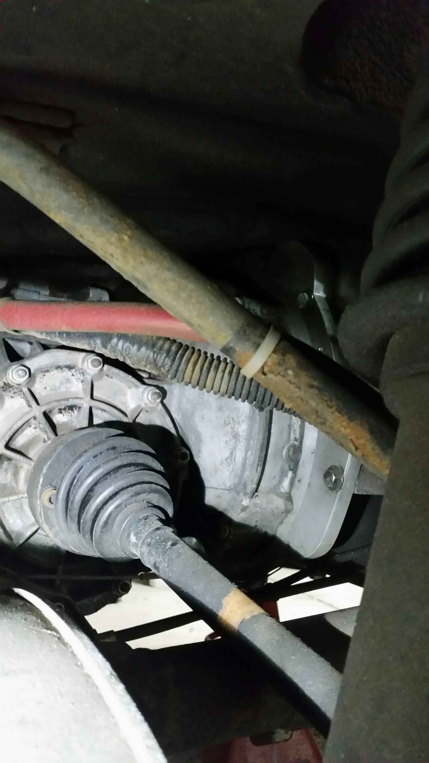

No problem zip tying the battery cables to the rear swaybar, right?? It should be ok.. (IMG:style_emoticons/default/headbang.gif) Attached Image Attached ImageAttached Image

LeftCoastErik   and some more No problem zip tying the battery ca...   May 14 2015, 10:05 AM

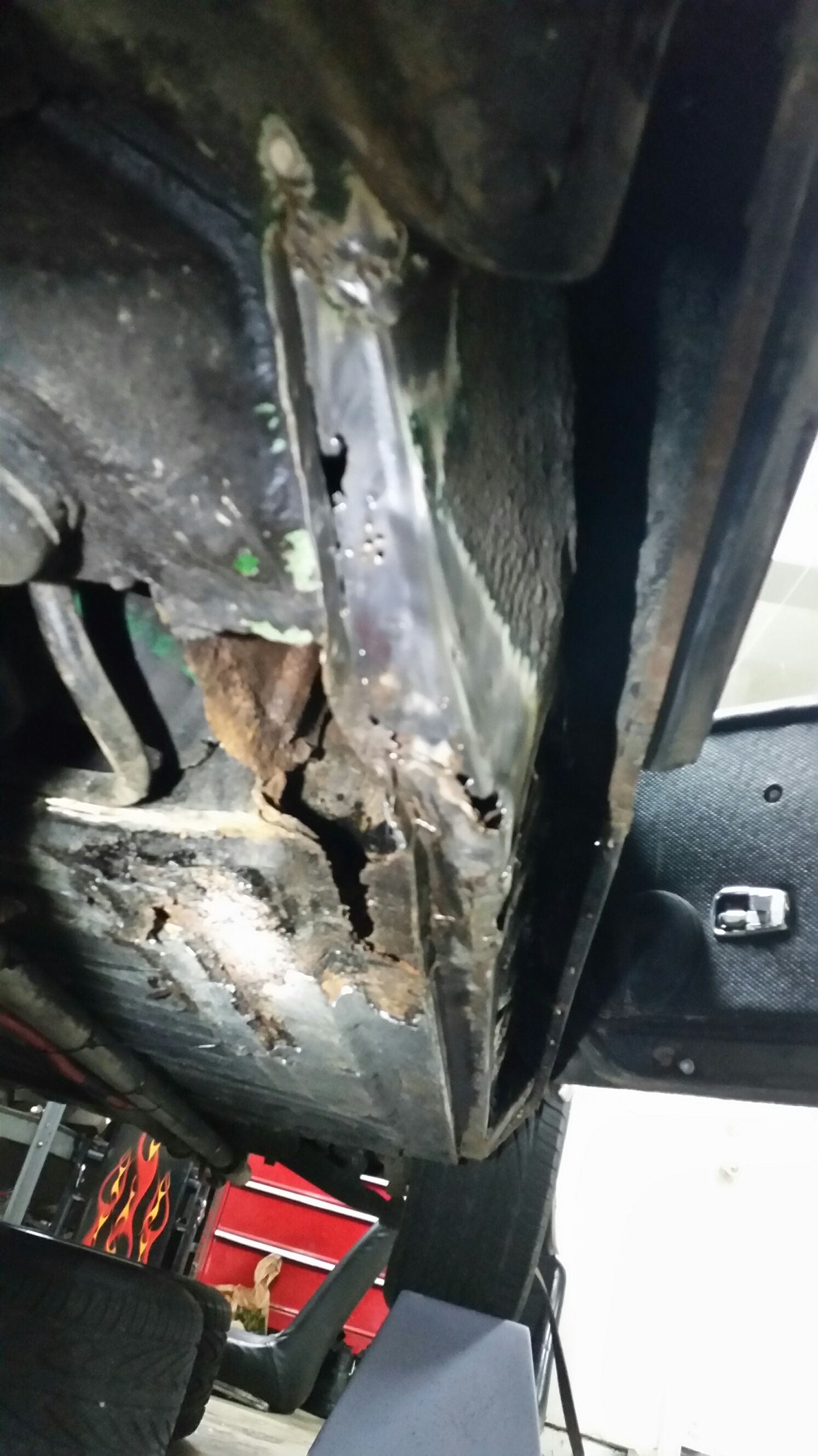

LeftCoastErik   So, yeah...going to be doing a lot of this :welde...   May 14 2015, 10:08 AM
rhodyguy   Bummer   May 14 2015, 10:15 AM
rjames   Bummer indeed. At least it looks like you have th...   May 14 2015, 10:44 AM
Mueller   Ouch....using the speaker to pick up the metal scr...   May 14 2015, 10:55 AM
matthepcat   Bummer about the rust. The car is going to look ...   May 14 2015, 11:50 AM
LeftCoastErik   Yeah, definitely a bummer, but stuff happens. My ...   May 14 2015, 12:03 PM

LeftCoastErik   Day 2 saw the removal of the rear right suspension...   May 15 2015, 10:13 AM
LeftCoastErik   Holes were added so I could spray Ospho in there a...   May 15 2015, 10:15 AM
