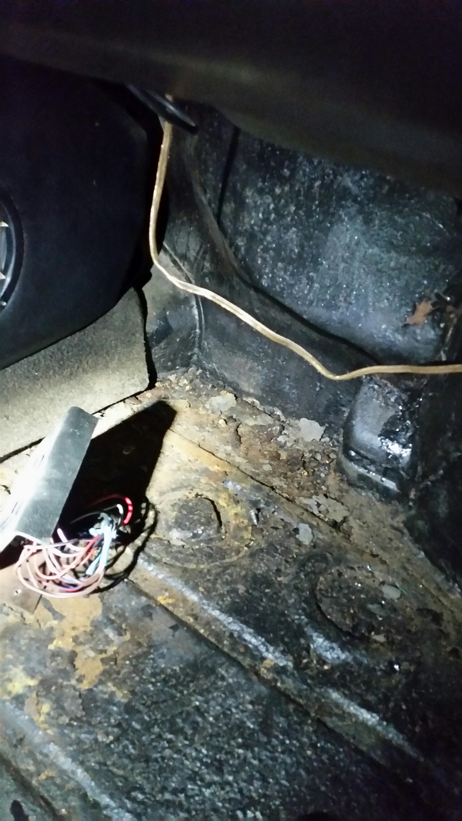

LeftCoastErik
post May 14 2015, 10:08 AM
BADPNNY
Posts: 173
Joined: 23-March 15
From: United States
Member No.: 18,555
So, yeah...going to be doing a lot of this (IMG:style_emoticons/default/welder.gif) for the next few days. I hope to get the longs in by tomorrow so that I can support it there and yank the front and rear suspension to bring down to the 914 swap meet in san jose on sunday
Wish me luckAttached ImageAttached Image

rhodyguy   Bummer   May 14 2015, 10:15 AM
rjames   Bummer indeed. At least it looks like you have th...   May 14 2015, 10:44 AM
Mueller   Ouch....using the speaker to pick up the metal scr...   May 14 2015, 10:55 AM
matthepcat   Bummer about the rust. The car is going to look ...   May 14 2015, 11:50 AM
LeftCoastErik   Yeah, definitely a bummer, but stuff happens. My ...   May 14 2015, 12:03 PM
whitetwinturbo   .........and I had this one on the "watch...   May 14 2015, 08:51 PM
r_towle   Dude, don't lose the magic speaker that goes b...   May 14 2015, 09:01 PM
