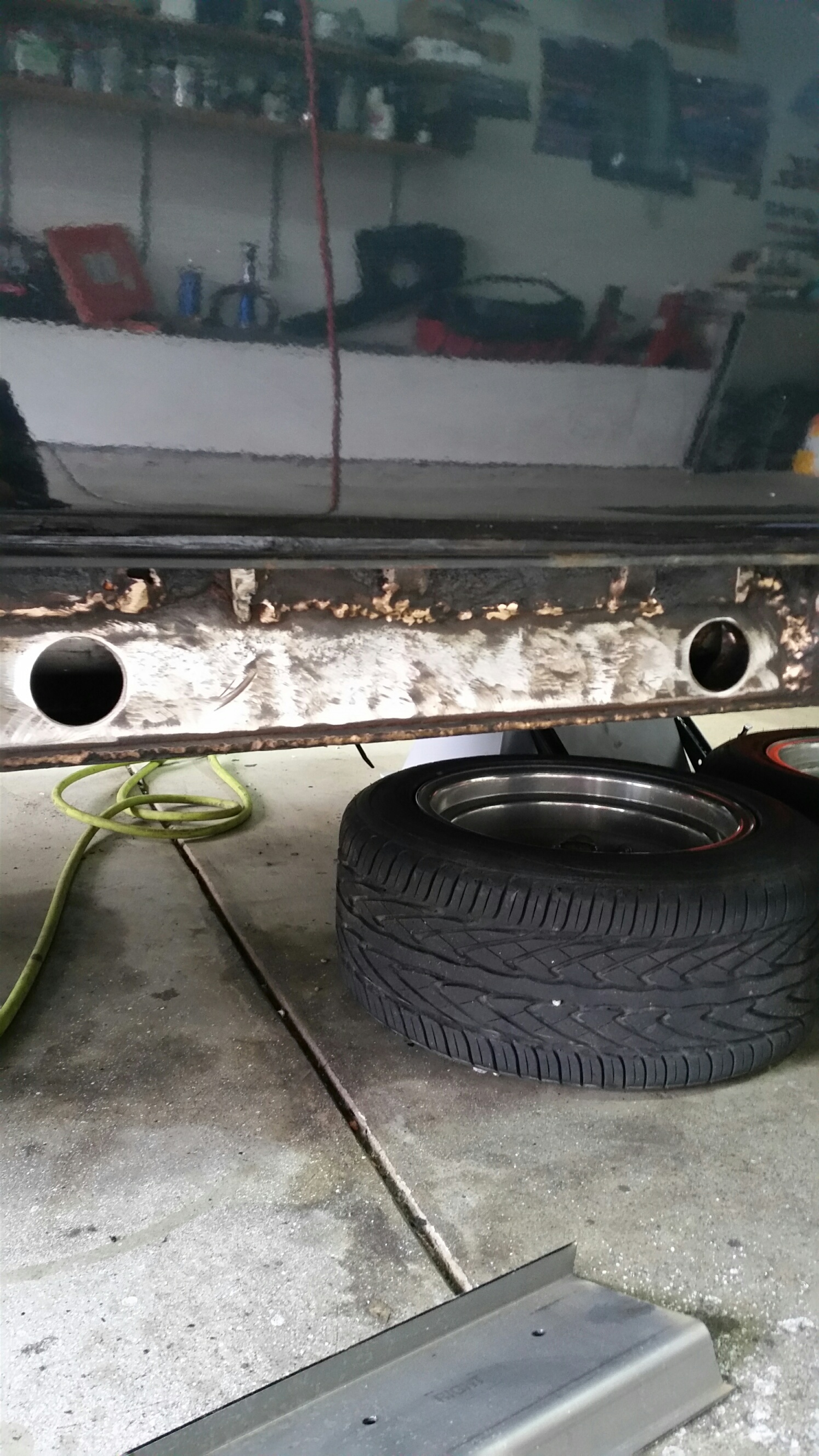

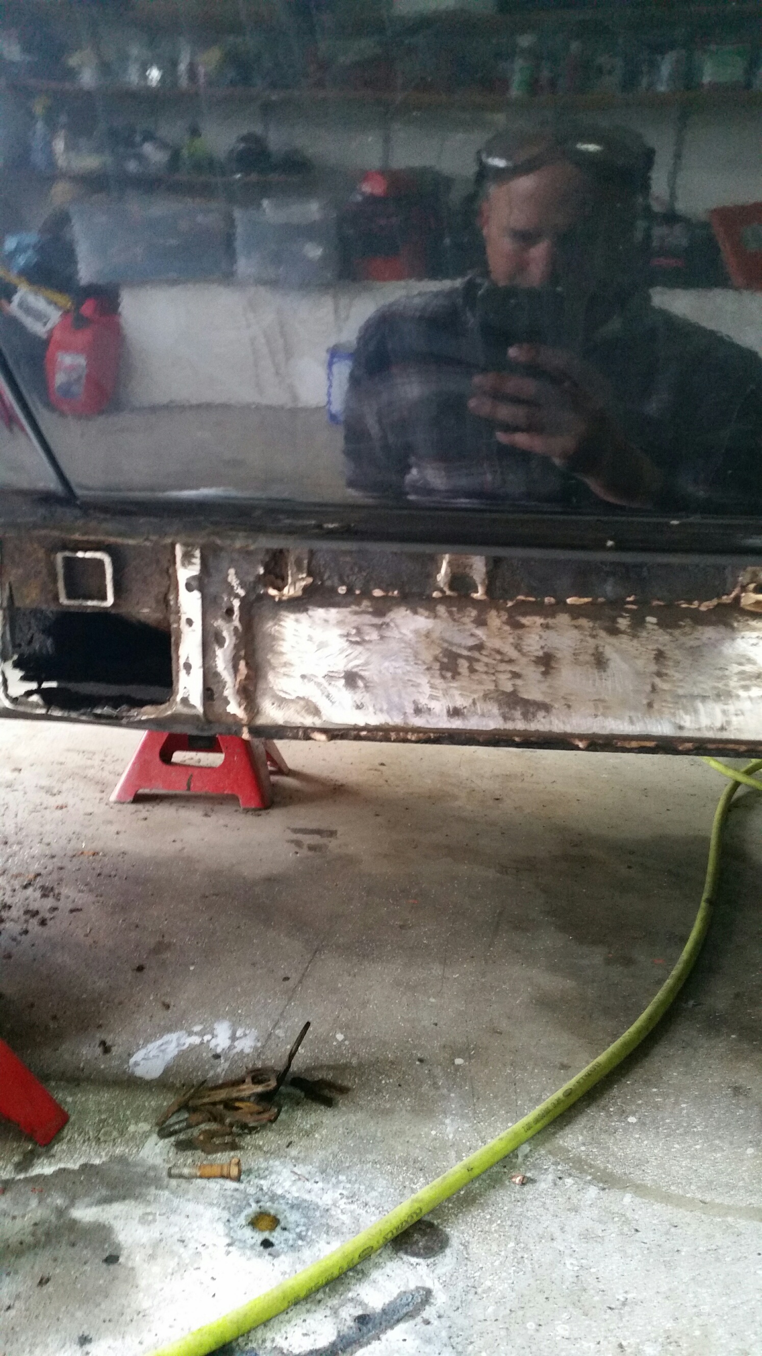

Day 2 saw the removal of the rear right suspension, complete with a broke off trailing arm console bolt...HOORAY! I soaked them for 2 days. 2 came out like butter. One rotated half a turn and snapped...Should be fun to remove.
It also appears that the long has been patched full length at some point in its history. Metal is good, and its gas welded with a goldish metal that is hard as hell. Not sure what it is, but I am guessing the welds aren't factory. The longs look nothing like the ones on my 73. I had to make spacer pieces to weld to the long to get the Mayeur kit to but up to and be able to plug weld. No biggie, but one more thing to deal with..
Hoping to get out today around 10am and put some more hours into it.Attached Image Attached ImageAttached Image

LeftCoastErik   Day 2 saw the removal of the rear right suspension...   May 15 2015, 10:13 AM
LeftCoastErik   Holes were added so I could spray Ospho in there a...   May 15 2015, 10:15 AM
