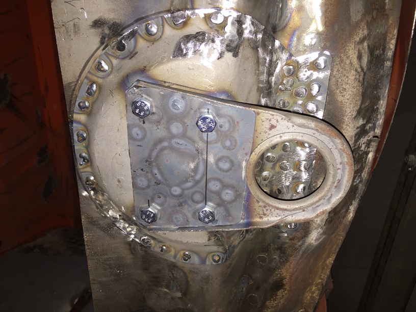

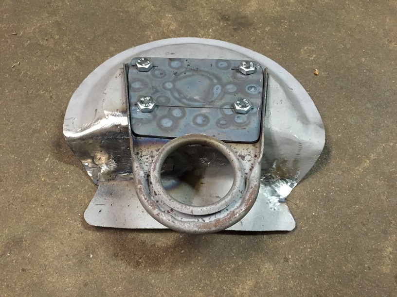

I made some more progress this week. I finally got the front tow hook fabricated and welded the nuts in place.
Then I welded it to the lower front valence that I had reinforced previously.
Test fit the modified tow hook in place and everything fit perfectly.
The next item to work on is the battery tray assembly. I think I will keep it in the stock location but modify it so that I can bolt it in instead of welding it in. That should make painting the area easier and allow me to remove it if necessary. I saw it was done this way on the 914-6 GT website. Any thoughts on this idea are welcomed.

I recently welded in the battery support on mine then epoxy primered it before I attach the tray itself. Hmmm, wondering about your bolted tray idea; might be a good idea for painting and cleaning behind later I suppose. I'm going to think about that for my build..
