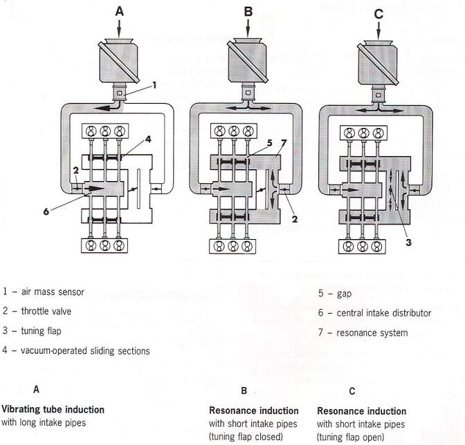

A new intake plenum and runners have been on the "to do" list for a while now.
While doing some reading the specs. on the Cayman, I noticed "variable length intake system."
Of course this got me thinking....." 914 retrofit!!!!".
Anyone ever tried this?
screenguy914
post May 18 2015, 12:36 PM
Posts: 249
Joined: 6-July 09
From: So. Cal
Member No.: 10,540
I suspect adapting onto a different engine will be a WAG as to whether runner length and ID are optimized for the engine. And if not installing on a 911 engine, what do you do with the extra runners?
And then, the method of controlling the VarioRam hardware.
