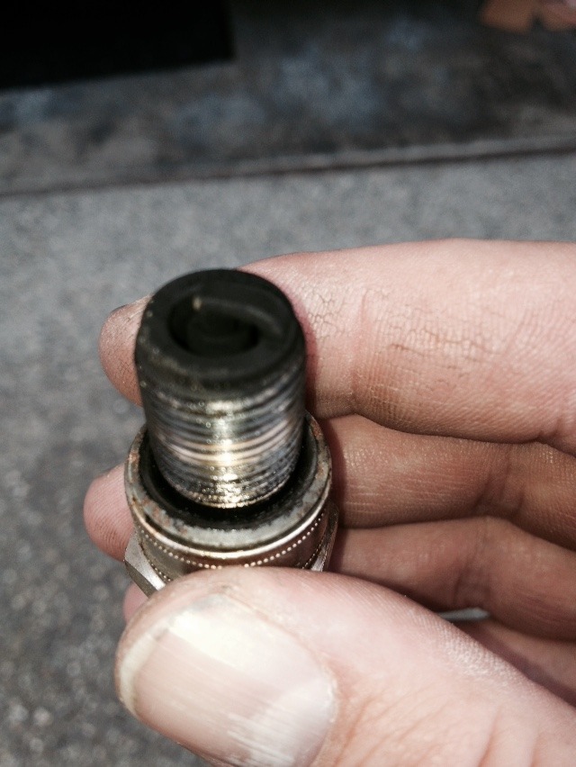

Last month I took the carbed 2.0 out of my silver car and put in another 2.0 with Djet. She's been a daily driver since then, and has done well except for running really rich, with the associated rough cold start and nearly impossible "hot" start. She was also getting MAYBE 15 mpg.
Thursday night, I started the car after going into the store and it would barely fire up, running VERY choppy, like it was missing on a cylinder or more. It also wouldn't hold idle at stop lights (it would sputter and die and then refuse to re-start) and surged and sputtered as it went down the road, the only way I made it home was to avoid stopping completely until I got home. Now, when I start the car, it surges and tumbles, putting out a MASSIVE amount of blue/black smoke and refusing to accelerate or idle (see video) and it smells super rich.

Replaced very fouled plugs that had been in the car for the past month, see pic)
