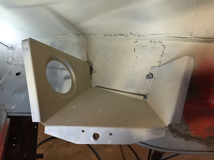

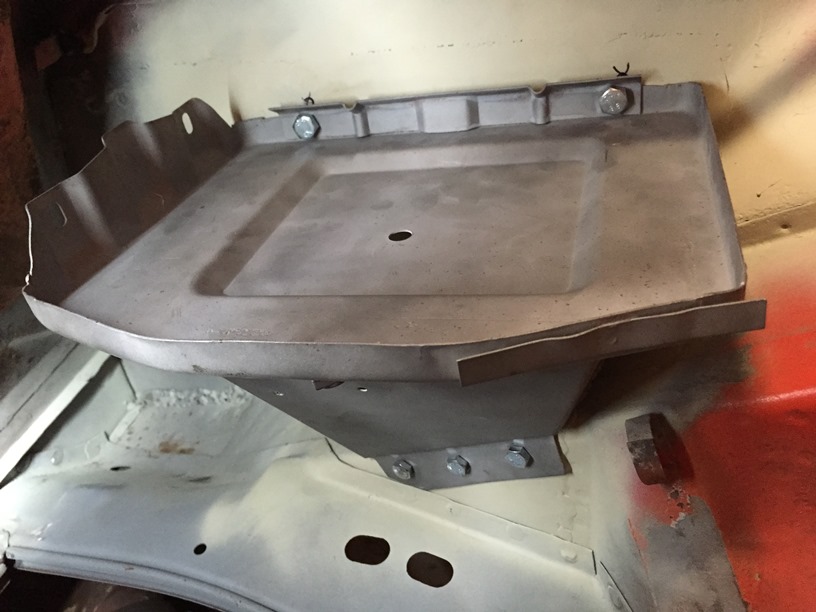

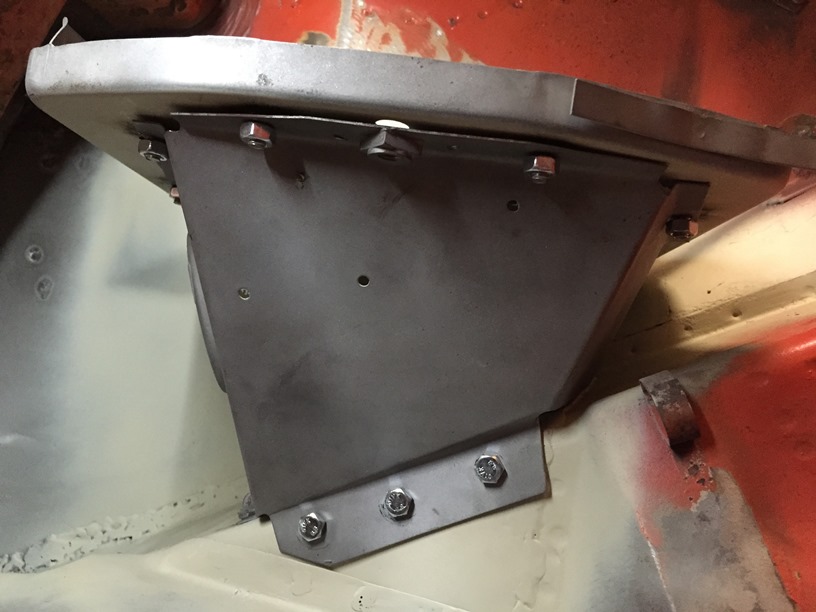

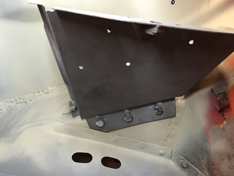

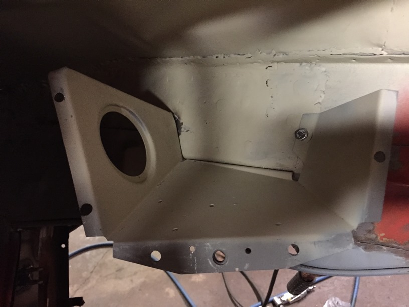

I went ahead with the bolt in battery tray idea this week. I drilled and tapped five 6mm holes into the reinforced frame section of the car to mount the lower part of the battery box.

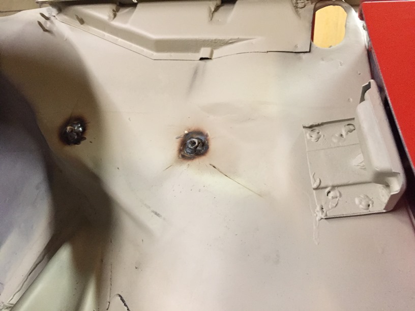

Then I drilled two holes through the top part of the battery tray for 8mm bolts and welded the nuts on the back side of the inner fender well.
I added clearance holes in the top of the lower battery tray support to accept five 6mm studs that I had stud welded to the bottom of the battery tray.
The test fit looks like everything will fit well once it is painted.
