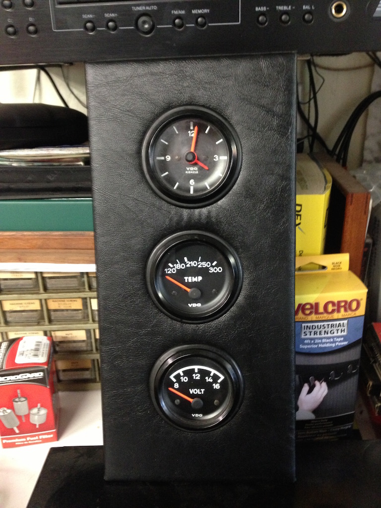

Here's a picture of the gauge panel before I put it back in the car, with temp gauge in the middle.Attached Image
