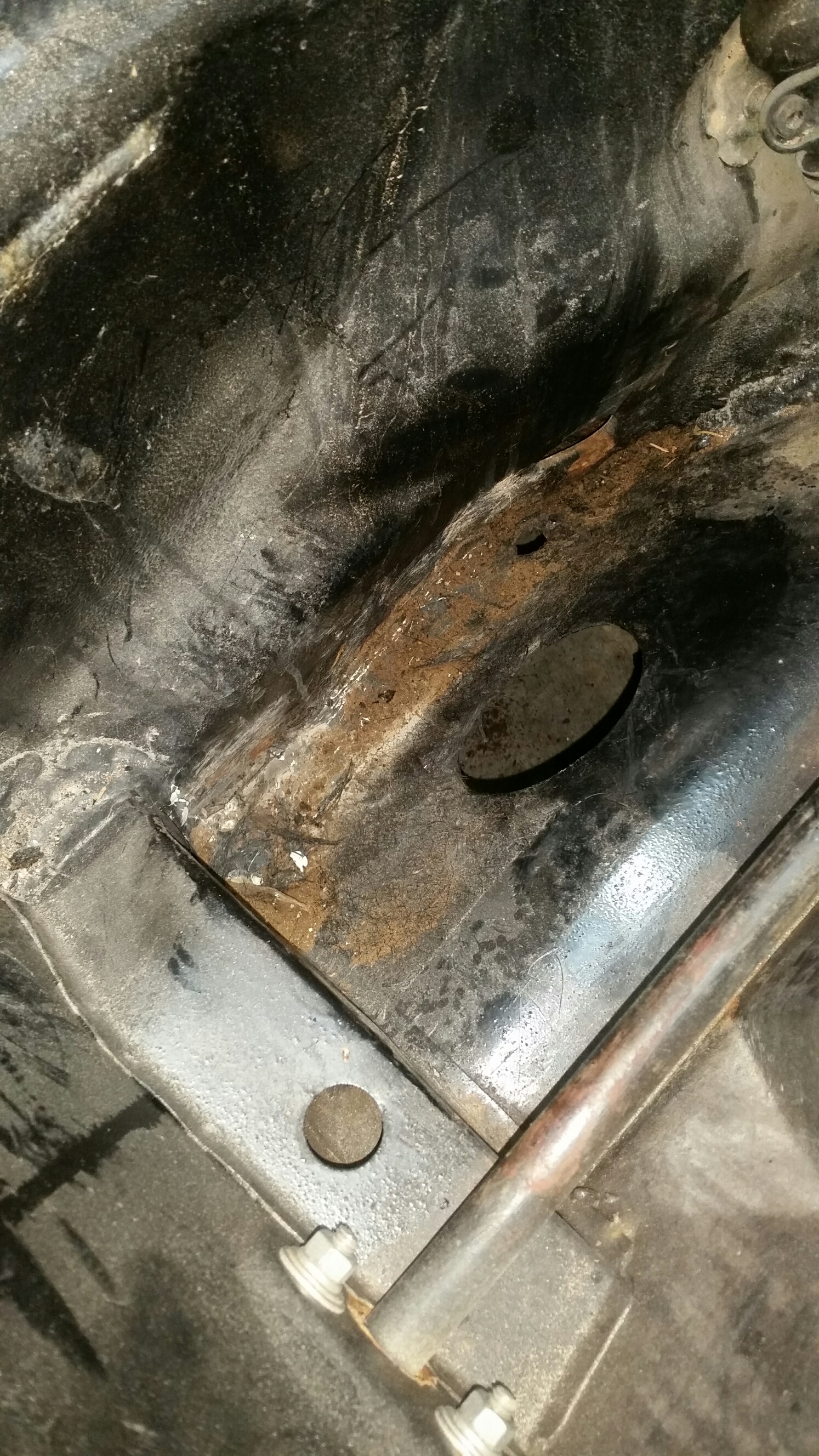

I think I am going to rename the car the FML914..Every time I take something apart I find another marginal repair. The bottom of the fuel tank hold was rusty at some point and poorly fiberglassed over. I can fix it, of course, but geez.
The car was originally irish green. but the front portion of the car looks like it may have once been light blue before being painted irish green and then black. I just have to keep going and reweld/reinforce everything..arggg...
Got fuel lines out so I can run a fresh -6 to the back to support the EFI thats on order. Going to relocate the battery cables through the center tunnel also (instead of strapped to the coolant pipes under the car) Started thinning out the wiring harness of extraneous wires. Decided to eliminate the relay board entirely. Going to a one-wire alternator as well.
My project board was fairly well crossed off, so it got wiped and re-written with a new list of excitement...
YIKES! Imagine if the insulation rubbed through those...probably nothing but could be... (IMG:style_emoticons/default/blowup.gif)
You're doing it right Erik. When you find a few weird things you have to go all the way down to square one and start fresh. There might have been a repair done if only one section was blue. It happens. As long as the tub is straight it's all good.

whitetwinturbo   Eric, you are the "welding MAN"! :w...   Jun 15 2015, 11:36 AM
LeftCoastErik   I am on my second big bottle of gas, and this spoo...   Jun 15 2015, 11:37 AM
LeftCoastErik   I decided to take another welding brake Saturday a...   Jun 15 2015, 11:39 AM
whitetwinturbo   :wub:   Jun 15 2015, 11:42 AM
LeftCoastErik   Thanks, I figured that out, but its a pain in the ...   Jun 15 2015, 11:42 AM
LeftCoastErik   The past few days have been eventful. Got the fue...   Jun 18 2015, 12:27 PM
whitetwinturbo   B:) Love all the new "jewerly"......have...   Jun 18 2015, 02:22 PM
howlndog   yes, have a good vacation.... but more importantly...   Jun 18 2015, 02:26 PM
