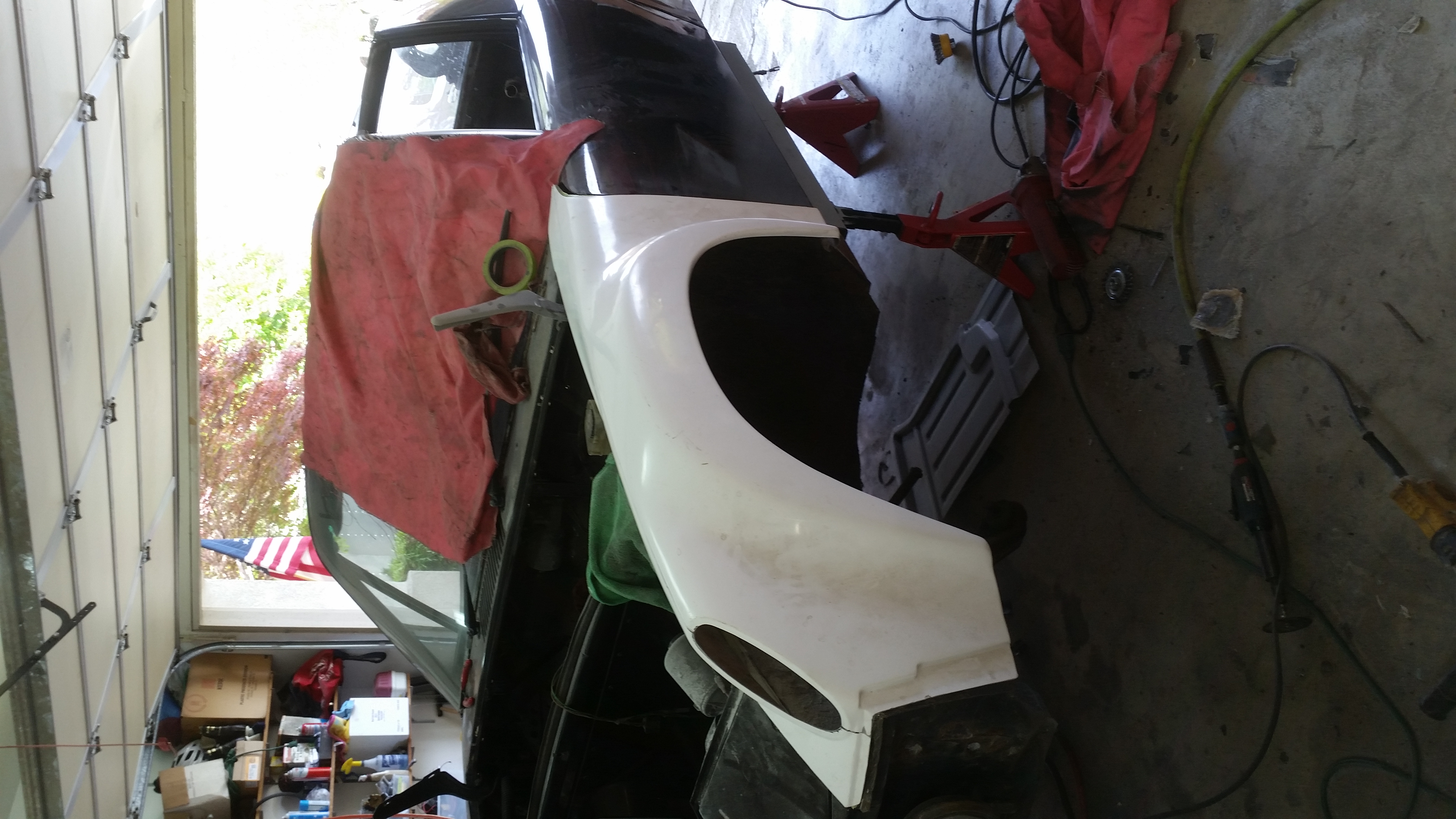

LeftCoastErik   Yesterday I got the rear inner fenders cleaned and...   May 30 2015, 08:20 AM

LeftCoastErik   More pics from the weekend. Got the entire GT rei...   Jun 1 2015, 10:33 AM
whitetwinturbo   Had this on "watch" too..........and I...   Jun 1 2015, 10:25 PM
whitetwinturbo   Is the white GT front fender replacement fiberglas...   Jun 1 2015, 10:34 PM
LeftCoastErik   Yes. From QRS   Jun 1 2015, 10:36 PM
Andyrew   My my my thats a lot of welding!!   Jun 1 2015, 10:48 PM
LeftCoastErik   Yeah. They seem like small parts..but it adds up. ...   Jun 1 2015, 11:05 PM
