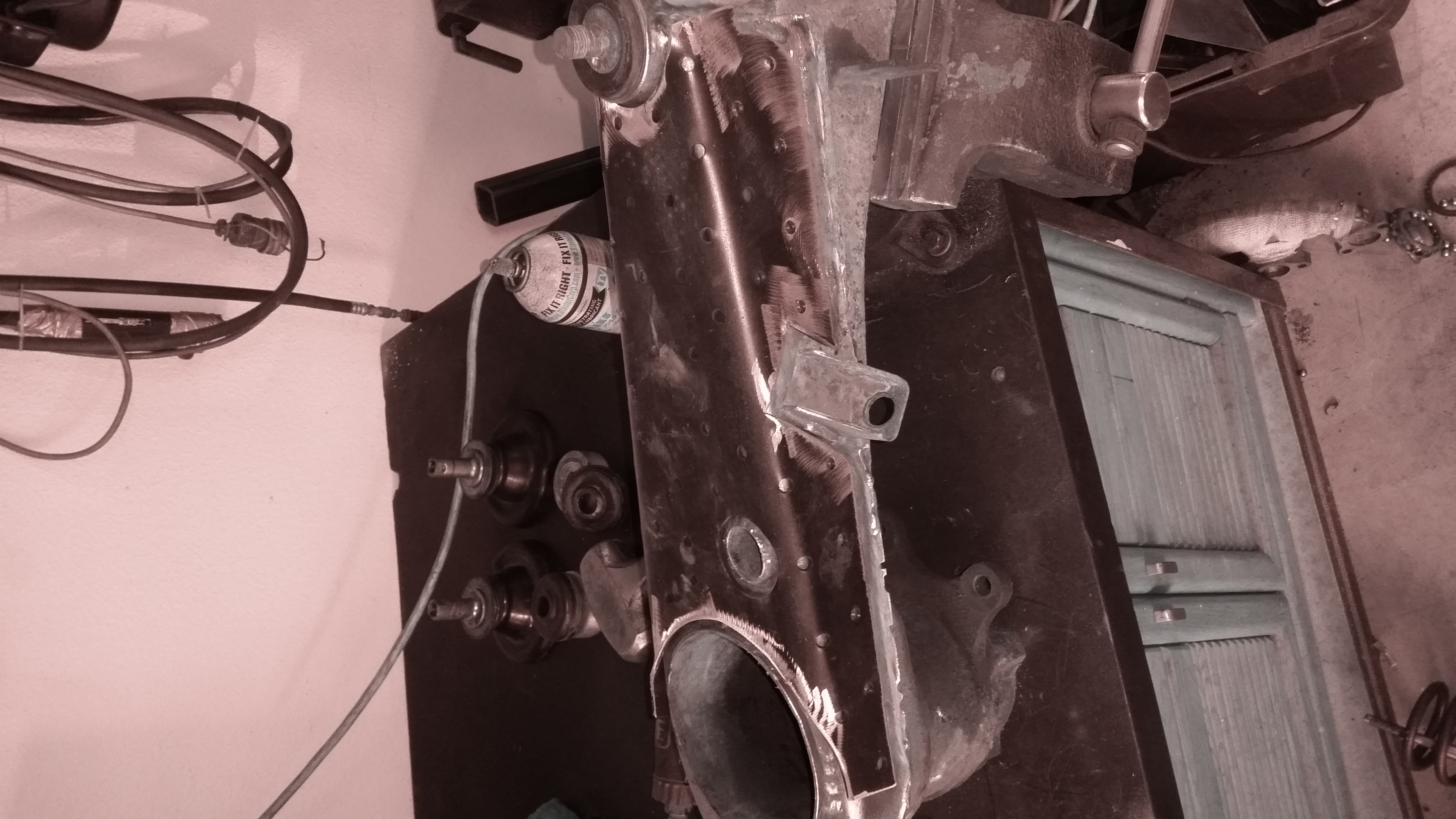

Trailing arm

LeftCoastErik   Trailing arm   May 30 2015, 08:21 AM
