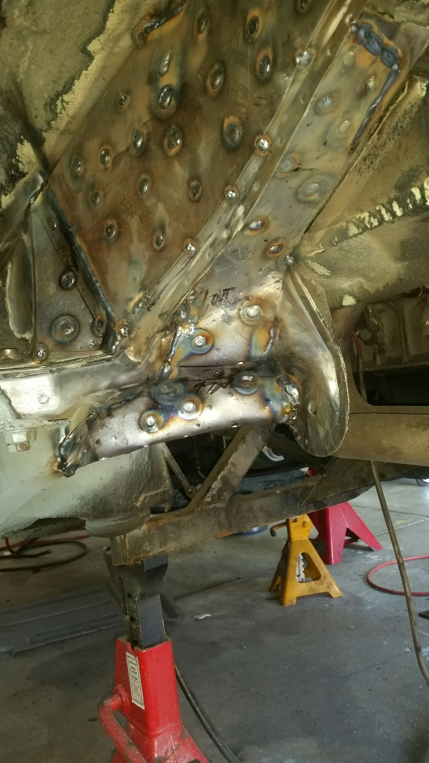

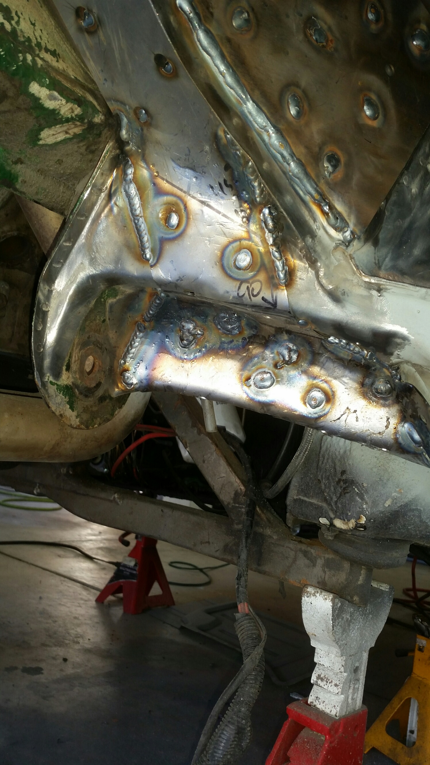

More pics from the weekend. Got the entire GT reinforcement kit welded in. Got the trailing arms boxed and ready to go to powder coat.

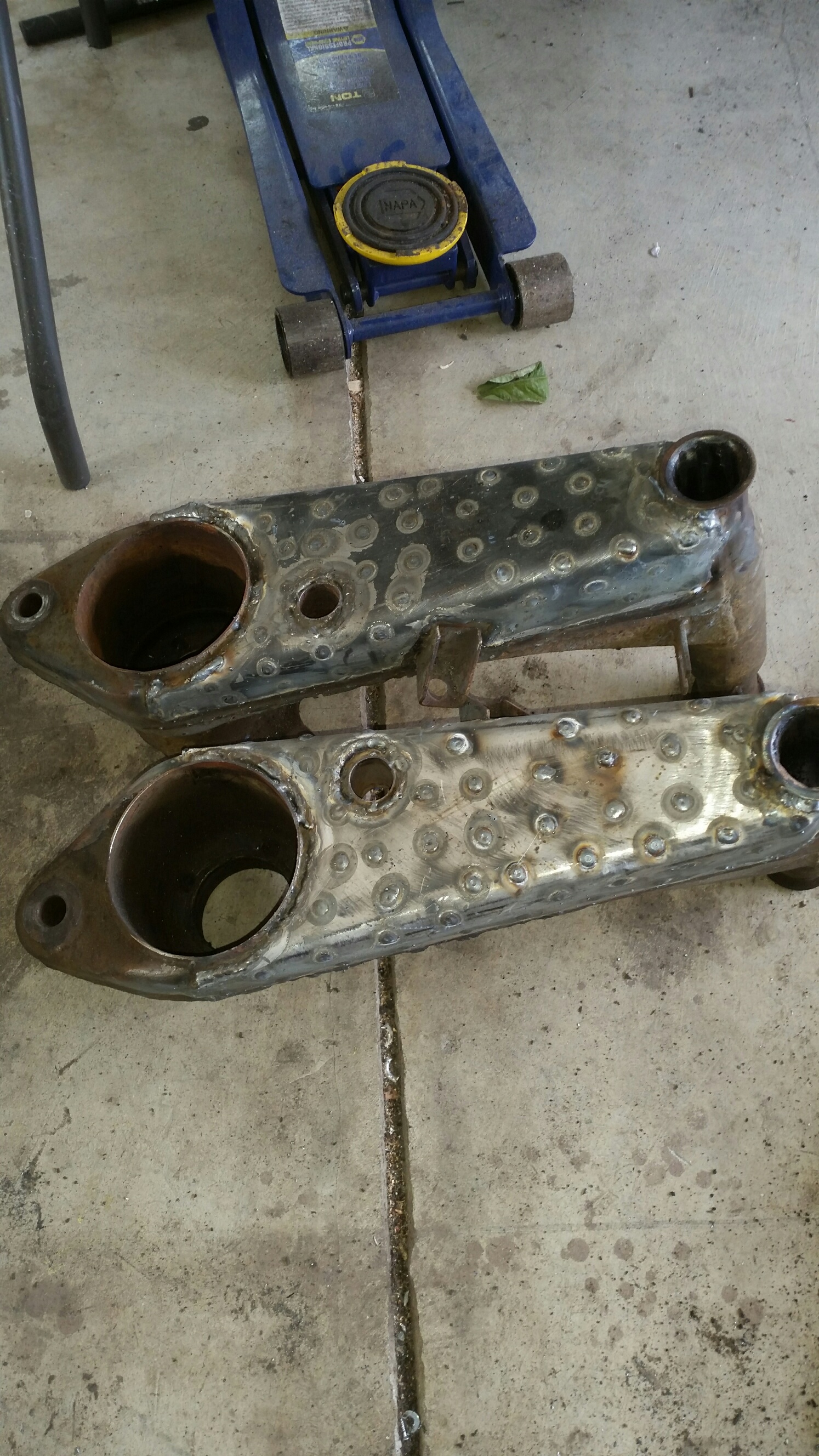

LeftCoastErik   More   May 30 2015, 08:20 AM
LeftCoastErik   Trailing arm   May 30 2015, 08:21 AM
LeftCoastErik   More pics from the weekend. Got the entire GT rei...   Jun 1 2015, 10:33 AM
whitetwinturbo   Had this on "watch" too..........and I...   Jun 1 2015, 10:25 PM
whitetwinturbo   Is the white GT front fender replacement fiberglas...   Jun 1 2015, 10:34 PM
LeftCoastErik   Yes. From QRS   Jun 1 2015, 10:36 PM
Andyrew   My my my thats a lot of welding!!   Jun 1 2015, 10:48 PM
LeftCoastErik   Yeah. They seem like small parts..but it adds up. ...   Jun 1 2015, 11:05 PM
