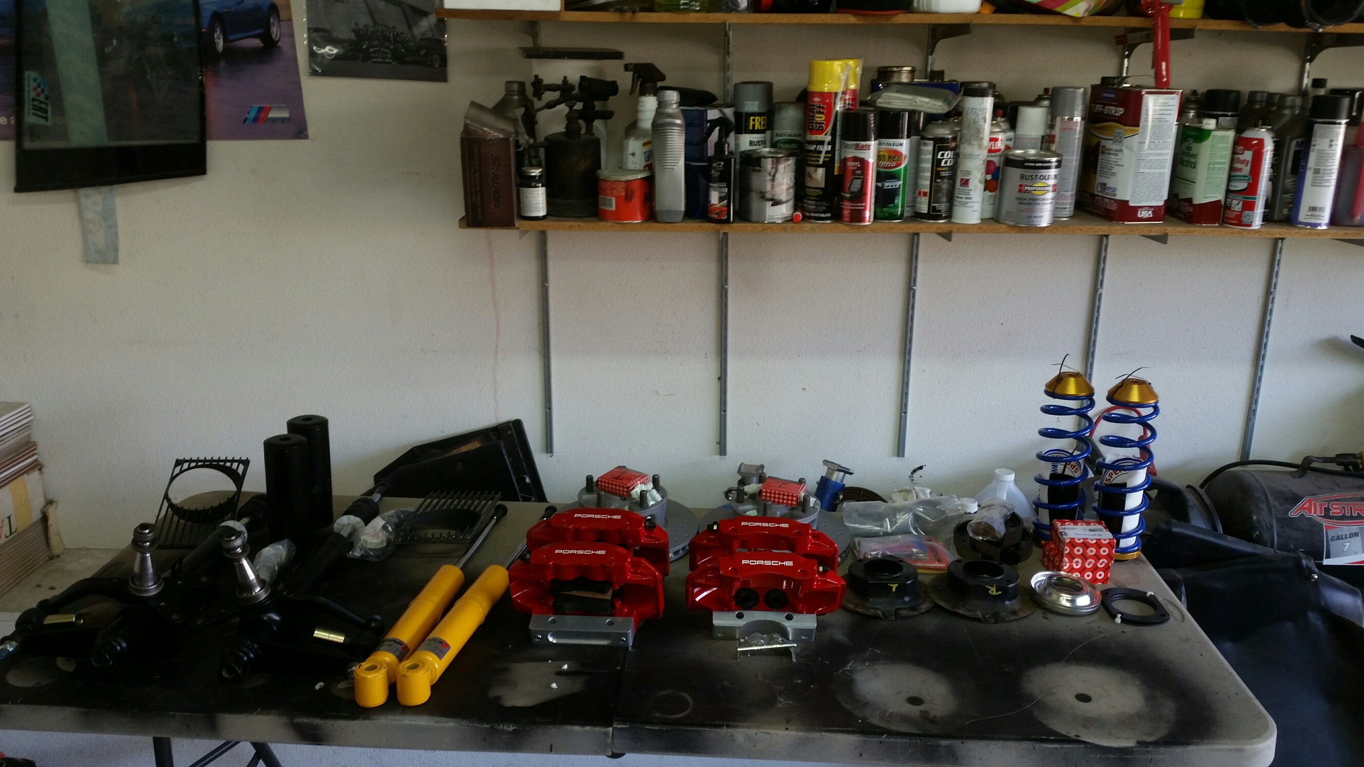

I got the dash top pulled to have Tri Valley Auto Glass and Upholstery re-cover it in black ultra leather with double stitched silver thread. I made some fillers for the dash vents too, so those will be covered when they do the bottom half.
I got the relay board out of the harness entirely and fixed a bunch of other little wiring issues.
Got the GT reinforcement kit final welded and painted so re-assembly can resume.
Rich Johnson sent me a bunch of packages with some serious awesomeness in them! If you have never dealt with Rich, he is awesome! He even hooked me up with some foglight grilles from his personal collection.
Hoping to have the powder coat stuff back today so I can start on the trailing arm reassembly this weekend
