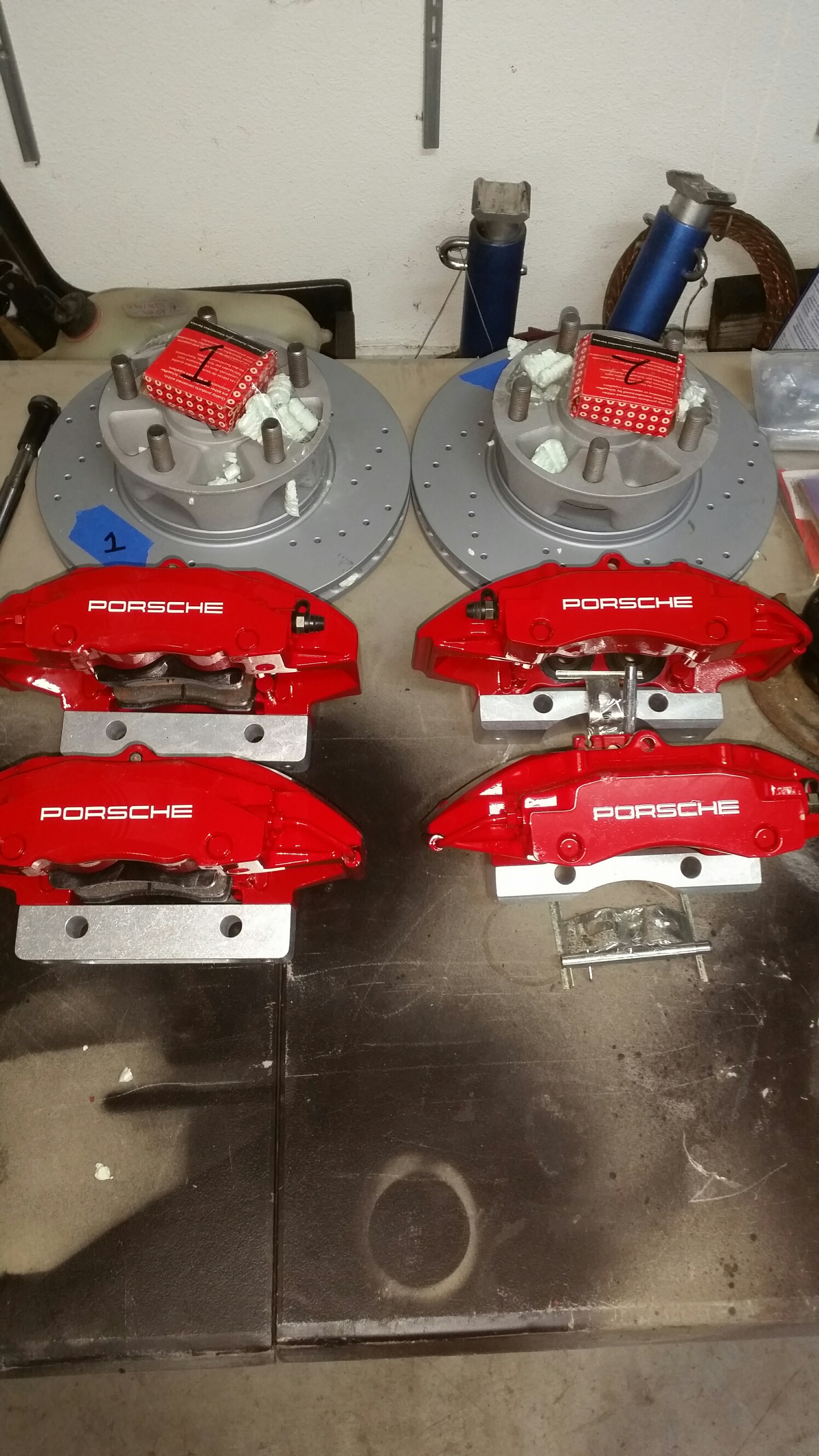

As for color...its either black or maaayyyybeeee......the color on this truck. Its actually a wrap and the color is called chocolate mocha. I like the way the color works with the black accents. I may have to get someone to photoshop a GT with the copper color. Anyone here have those skills?
Also a close up of the Boxter Brakes....
