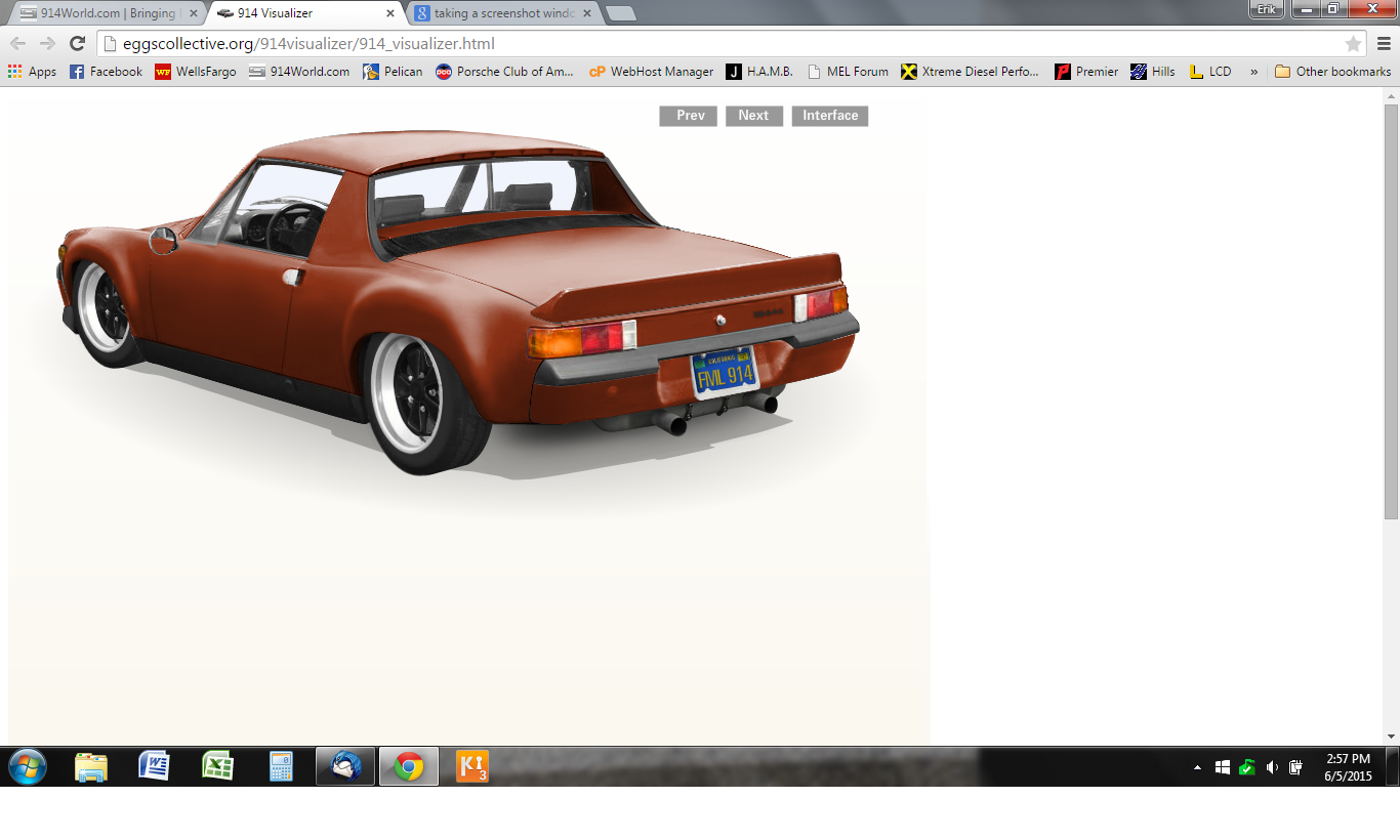

I took a stab at it...
I will be making a custom muffler with similar outlets to the GT one shown, but I am thinking of running the lower valance with the pipes coming through it.
Trim will be blacked out
No jack holes
Bullet style mirrors in Satin Black
Can't decide on the 911 style reflector or not...

LeftCoastErik   I took a stab at it... I will be making a custom m...   Jun 5 2015, 04:03 PM
craig downs   I love the color on that truck. That would look gr...   Jun 5 2015, 04:39 PM
whitetwinturbo   WOW..........Yes on that color! It will be 1 ...   Jun 5 2015, 04:39 PM
matthepcat   I say no to 911 reflector, but he'll yes to th...   Jun 5 2015, 06:08 PM
whitetwinturbo   I say no to 911 reflector, but he'll yes to t...   Jun 5 2015, 09:00 PM
