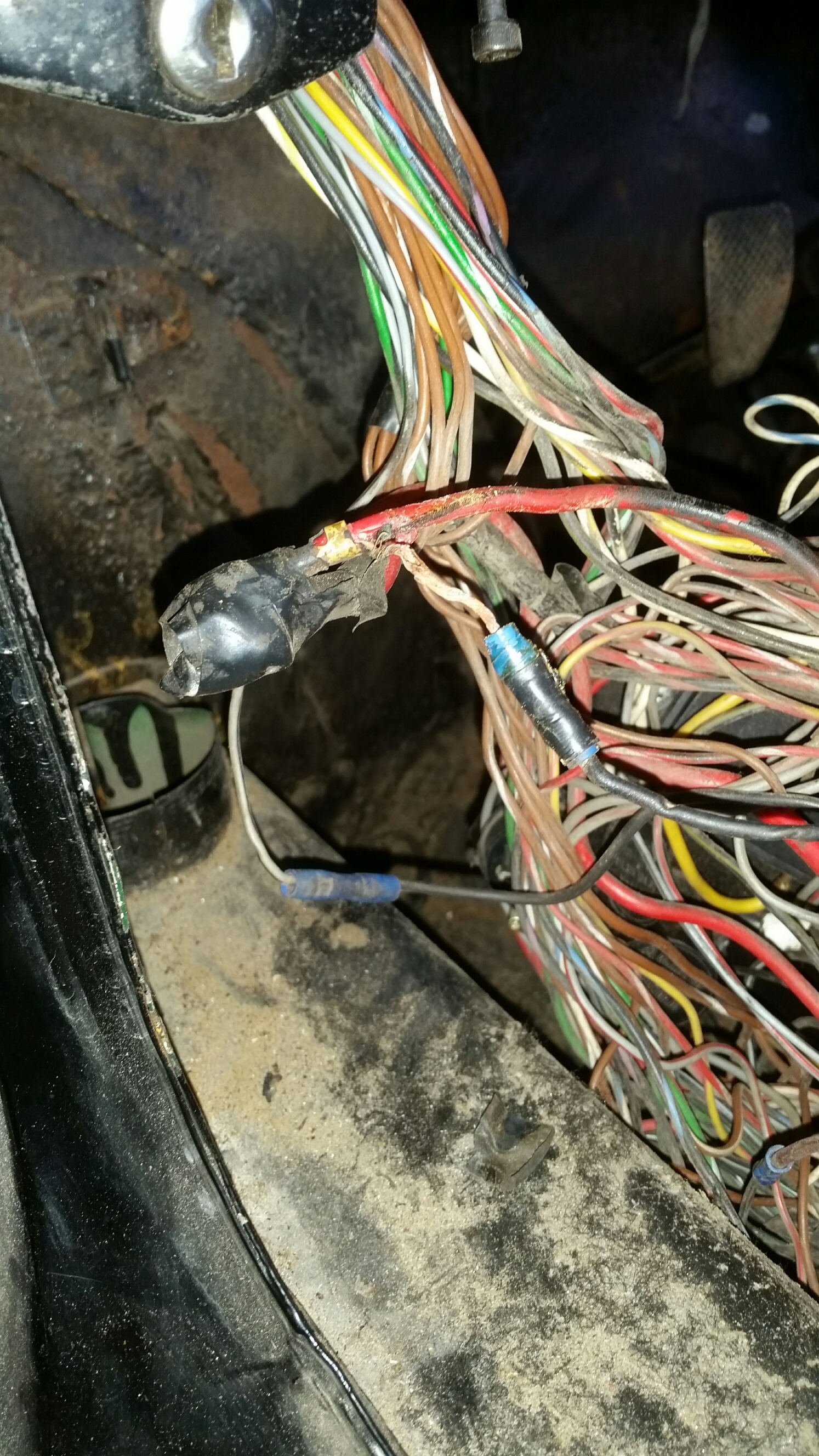

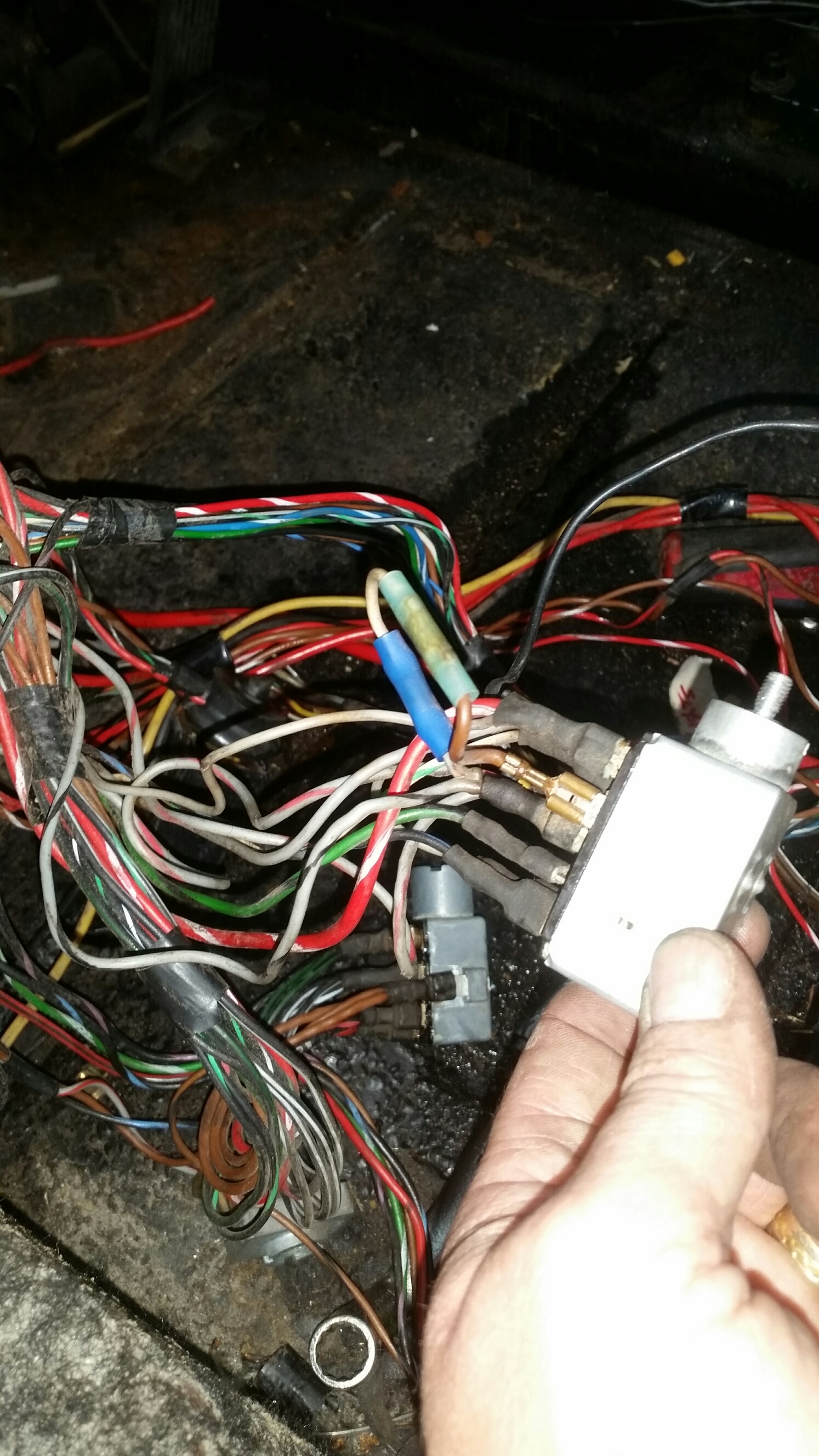

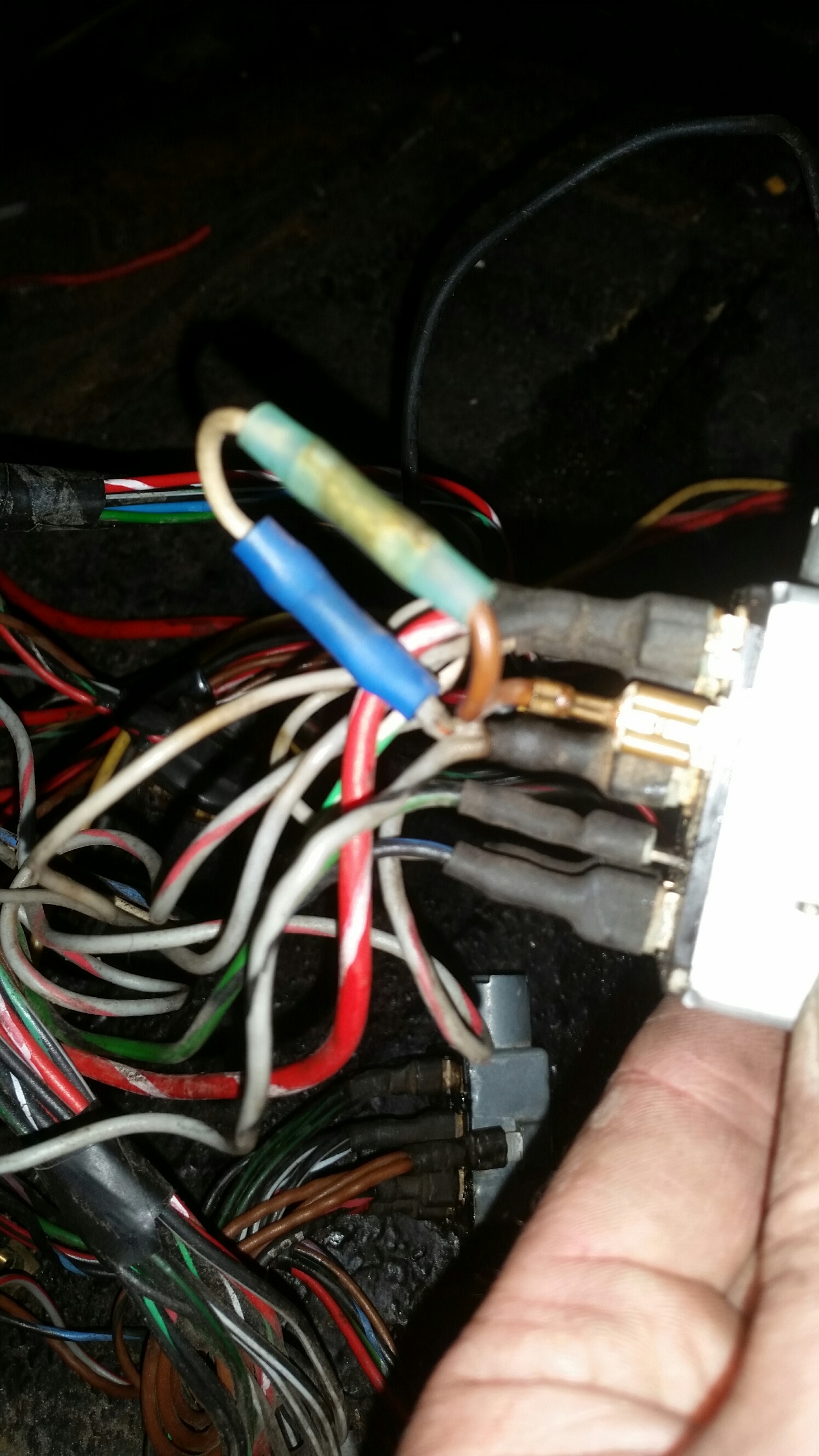

I got a lot done this weekend. I also cursed a lot, especially at the previous owner..
"No Significant Rust Issues" from the ad...See for yourself..
In addition to the rusty hole that was patched with fiberglass under the gas tank, the passenger floorboard at the firewall was goneski.
ANDDDD, I determined that the whole front of the car was actually grafted on from another car. Probably in 1984 when the they did the slant nose conversion. I am guessing it was an insurance wreck. Hooray..Oh well, I am too deep now. I am just reinforcing and strengthening everything I can and then I will put on my buddy's frame rack to make sure its straight
Arrgg Anyway, this first series of pics is the wiring completion. I found 4 wires melted together, the headlight switch wired incorrectly, and 3 broken wires that I actually need...
