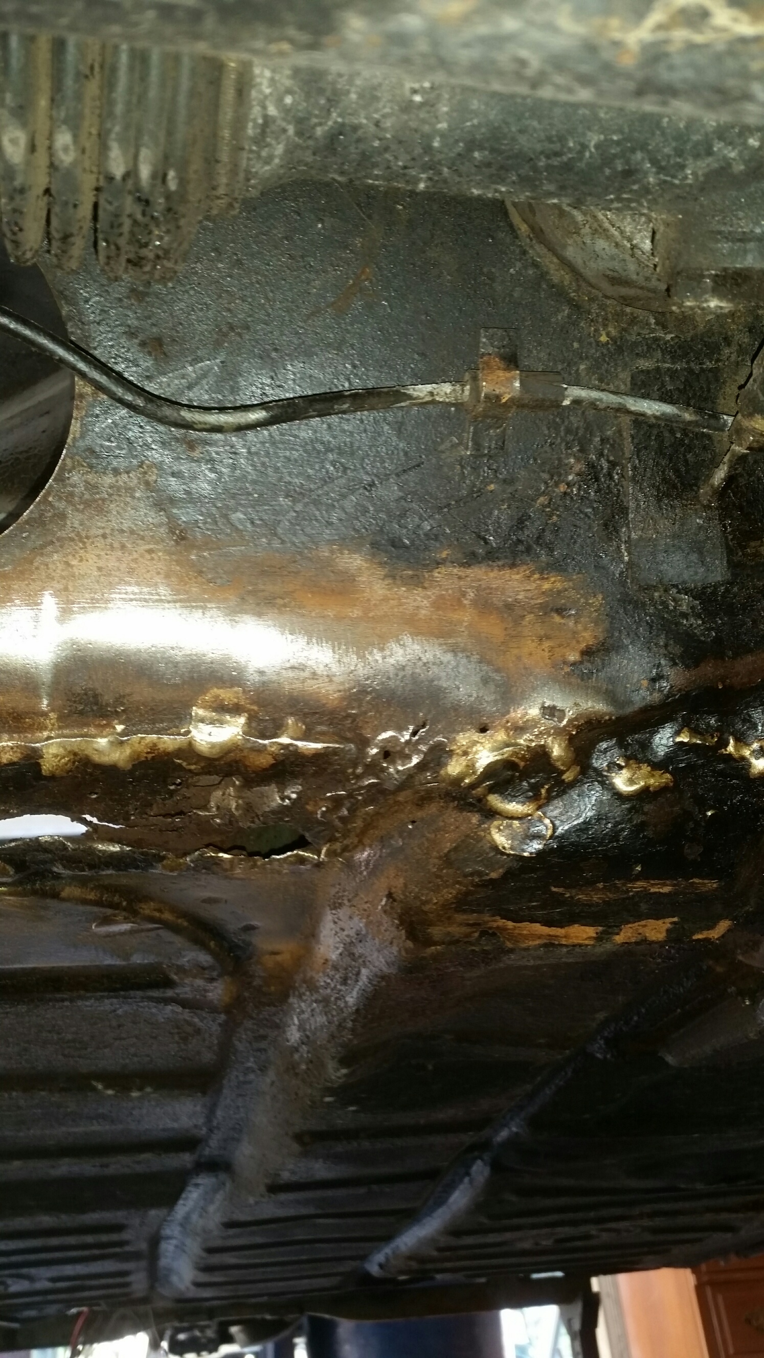

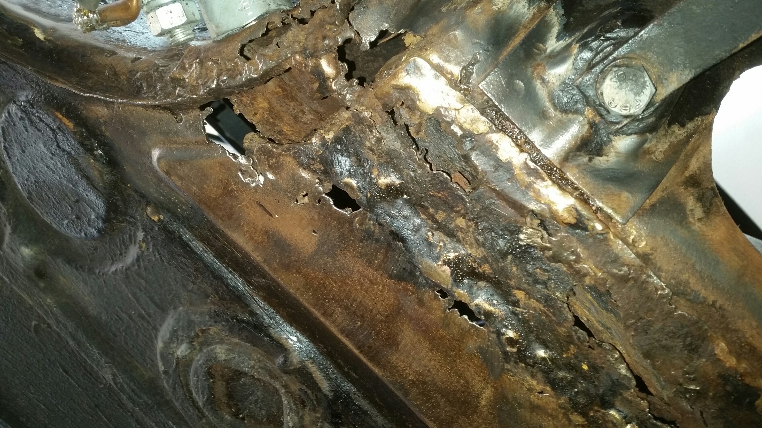

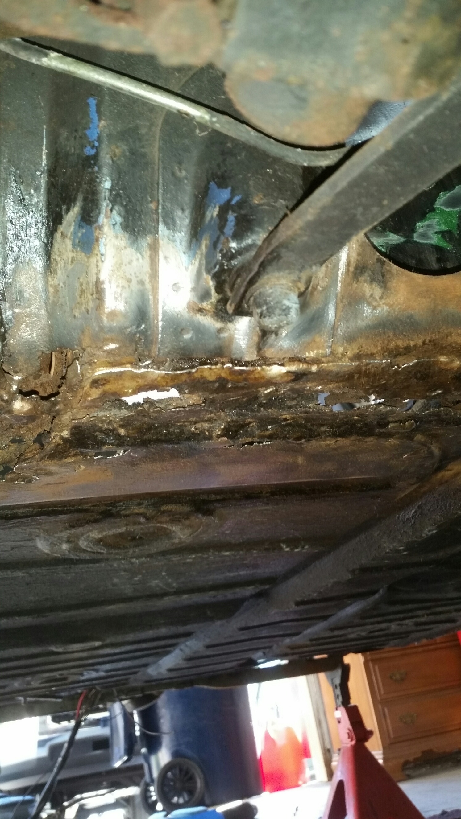

Here are some pics of the "Not-so-significant" rust and where the car was seamed together.

LeftCoastErik   I got a lot done this weekend. I also cursed a lo...   Jun 8 2015, 02:59 PM
LeftCoastErik   Here are some pics of the "Not-so-significant...   Jun 8 2015, 03:02 PM
LeftCoastErik   and the fixing..   Jun 8 2015, 03:04 PM
LeftCoastErik   last pic for now...More to follow after I get the ...   Jun 8 2015, 03:05 PM
