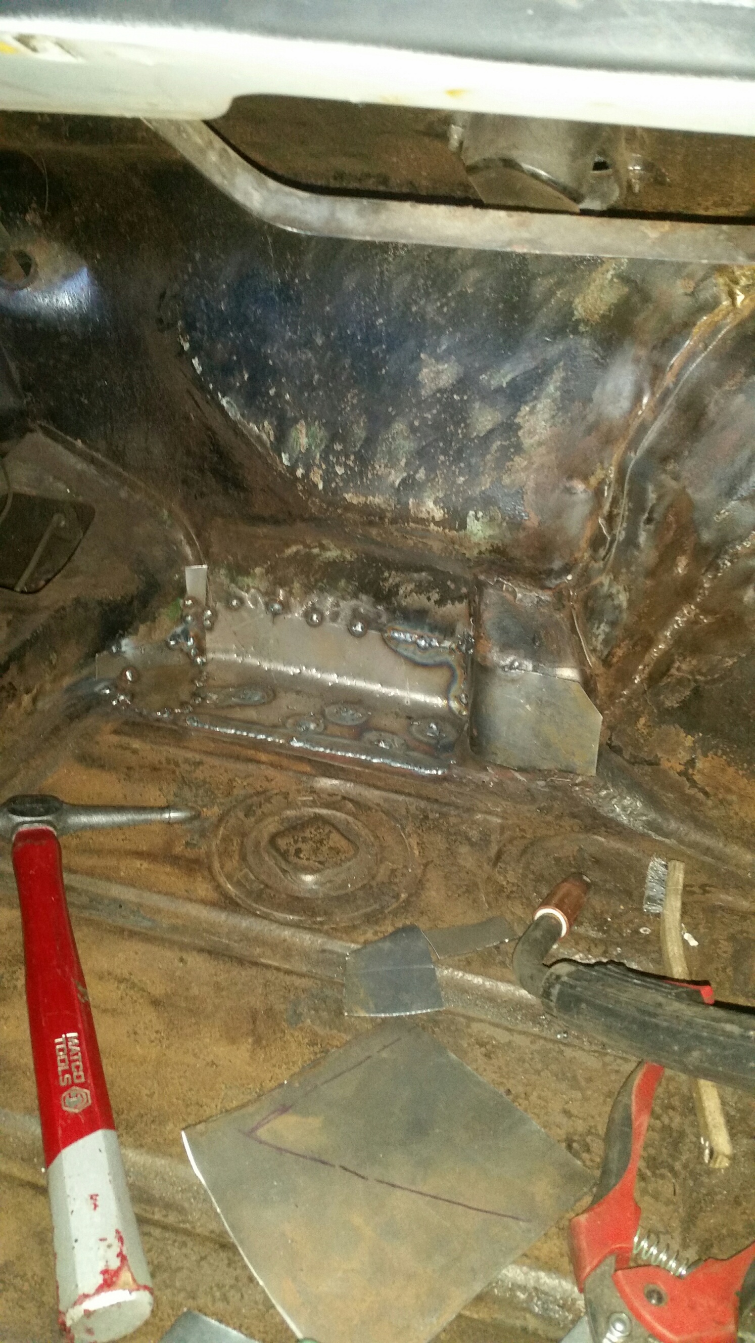

LeftCoastErik
post Jun 8 2015, 03:05 PM
BADPNNY
Posts: 173
Joined: 23-March 15
From: United States
Member No.: 18,555
last pic for now...More to follow after I get the passenger pan fixed up..
