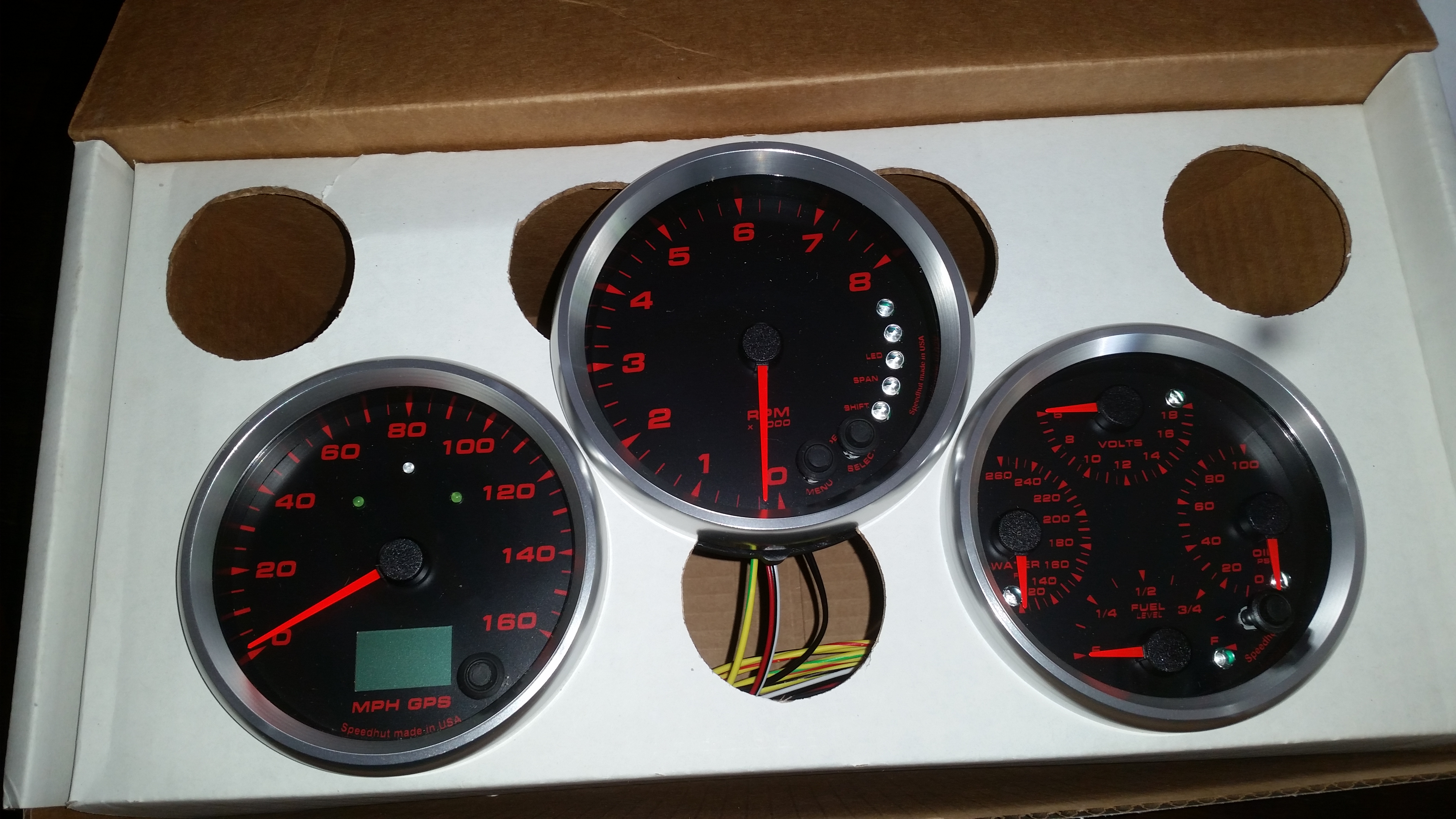

LeftCoastErik   On a positive note..I just came home to these beau...   Jun 8 2015, 05:38 PM
matthepcat   Nice! My GPS speed hut gauge took like 3 weeks...   Jun 8 2015, 05:48 PM
LeftCoastErik   Iirc they are 4" and the tach is 4.5   Jun 8 2015, 06:06 PM
