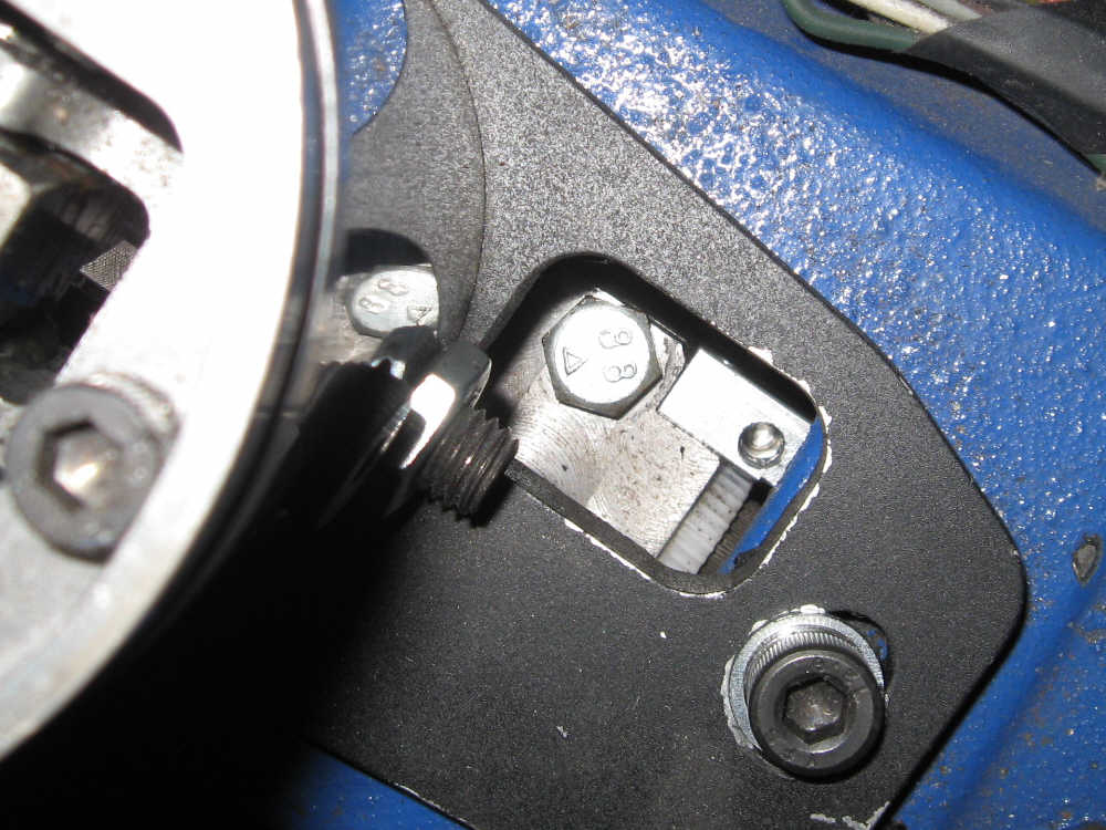

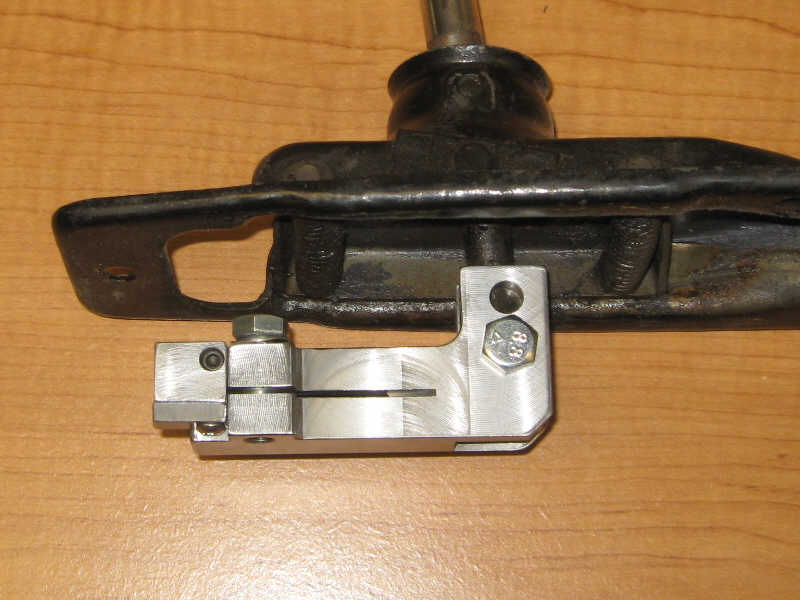

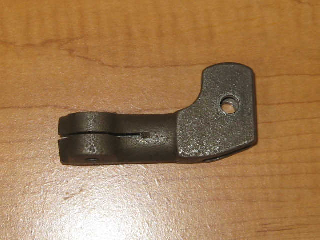

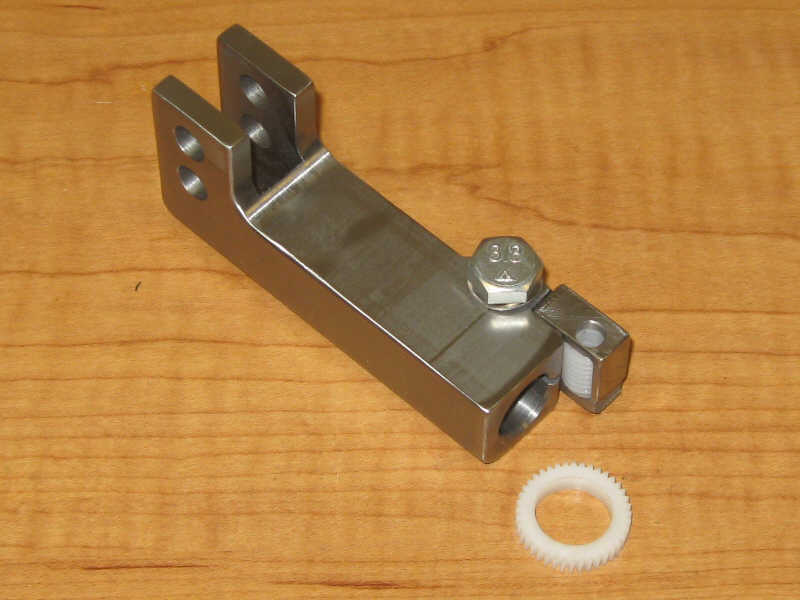

Replace this:
with this:
And make accurate adjustments without frustration in a minute.
