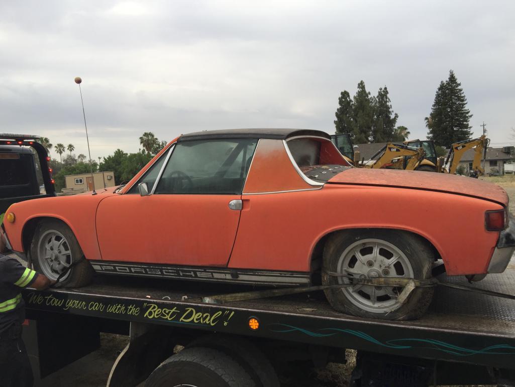

LukeD   come to find out the car has sat in this location ...   Jun 9 2015, 08:53 PM
LukeD   driver side   Jun 9 2015, 08:54 PM

LukeD   safe at home, just needs new tires, fresh gas and ...   Jun 9 2015, 08:55 PM
Chris H.   Right. In fact that tire can probably be fixed...   Jun 9 2015, 09:10 PM
Heeltoe914   Don't paint it..... if that the original paint...   Jun 9 2015, 08:57 PM
TargaToy   You daggone Californians. Doesn't anything ru...   Jun 9 2015, 09:04 PM
