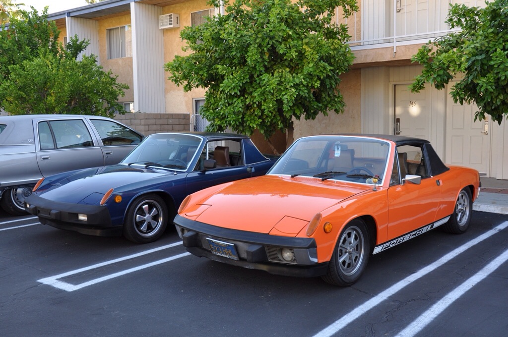

LukeD   safe at home, just needs new tires, fresh gas and ...   Jun 9 2015, 08:55 PM

72914wrx   Had the chance to meet Luke today really nice guy ...   Jun 14 2015, 11:42 PM
LukeD   Had the chance to meet Luke today really nice guy...   Jun 15 2015, 11:02 AM
