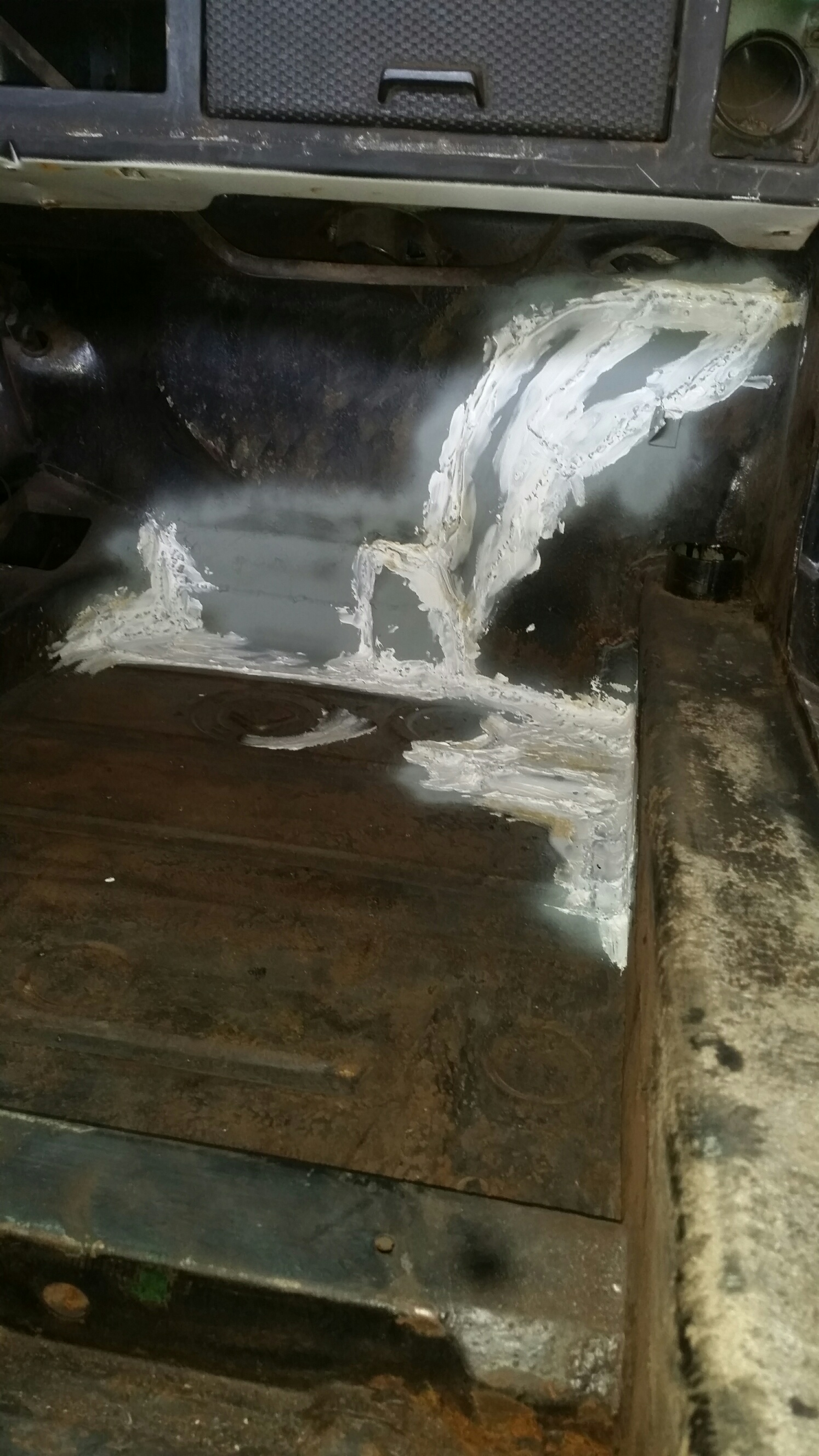

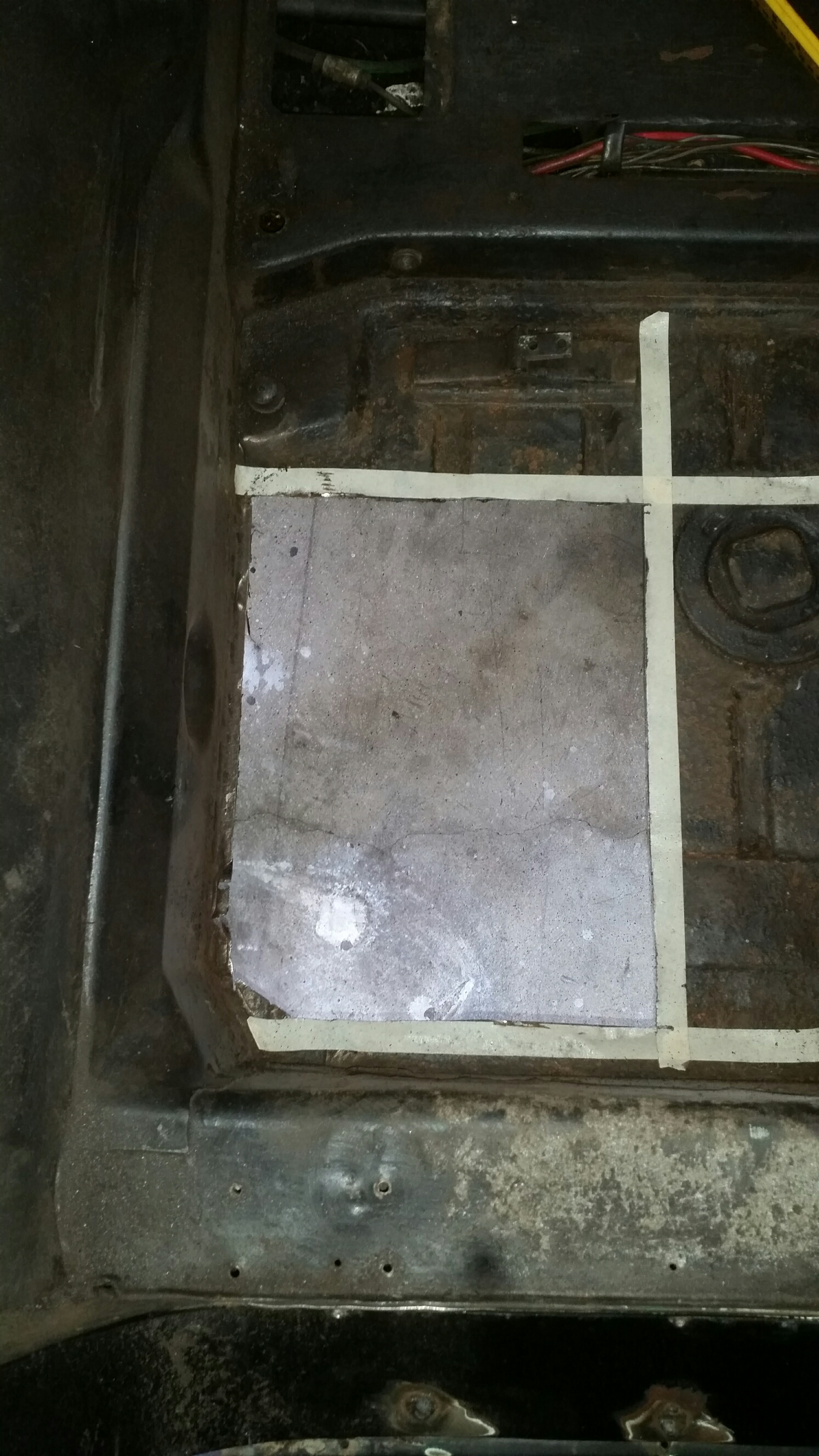

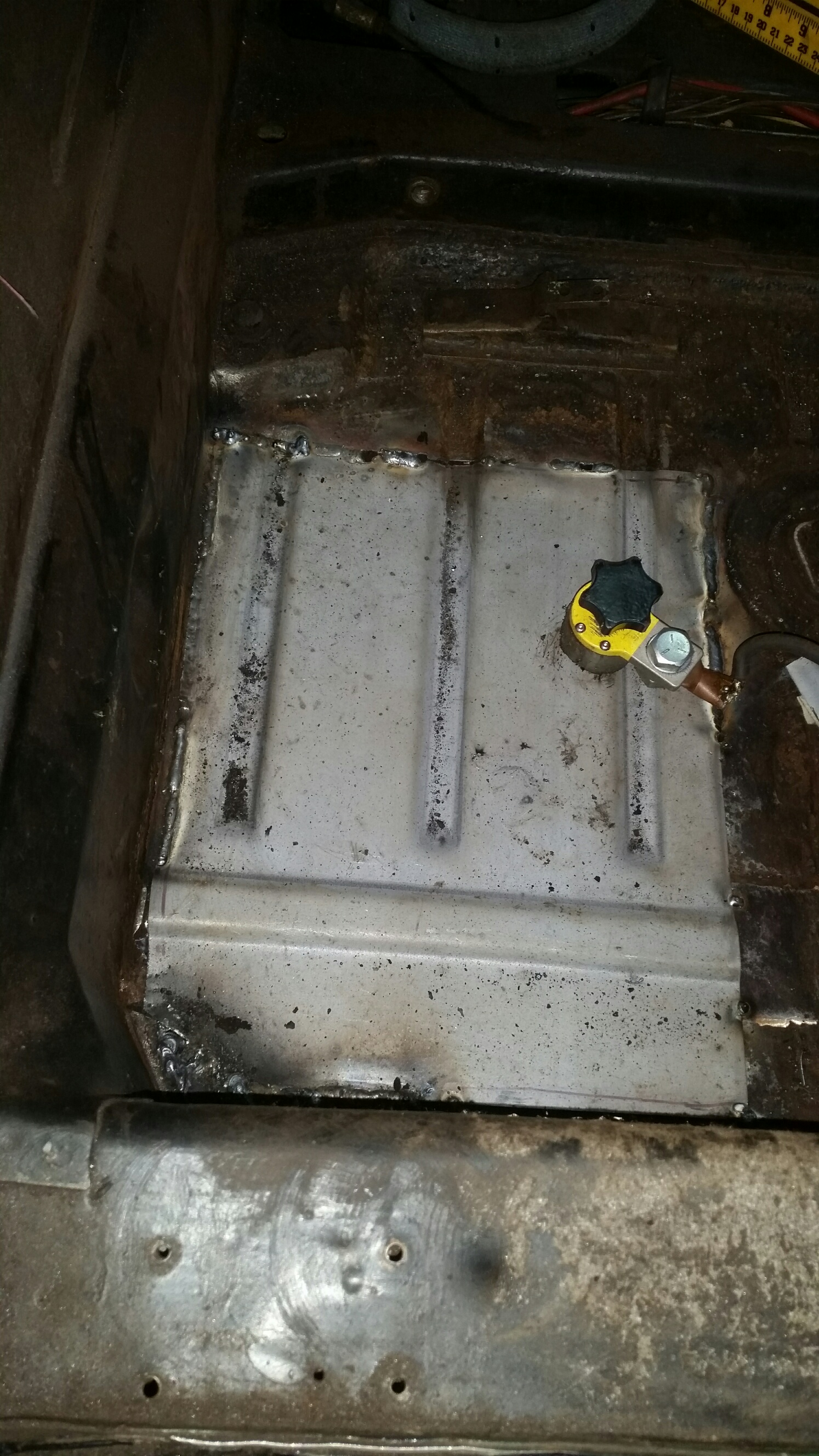

The #FML914 continues to live up to its name..I finished the passenger floor/footwell area and also made a bridge patch over the area where the car had been seamed together. Got that in, galvanized, and seam sealed.
Moved on to the rear pan on the passenger side. Had rust/fiberglass repair that I already knew about and had an RD half pan sitting on the shelf..The seat hinge pedestal on that side was hammered as was the area under the cross brace. I opened it up and Ospho'd the hell out of it. Ordering the new hinge and reinforcements from RD now.
Found a bunch of perforation on the driver's side also...I will get to that eventually...

TargaToy   Looking good, Erik! Do you like your magnetic...   Jun 10 2015, 04:00 PM
LeftCoastErik   Thanks!. Yeah I swear by it   Jun 10 2015, 04:06 PM
