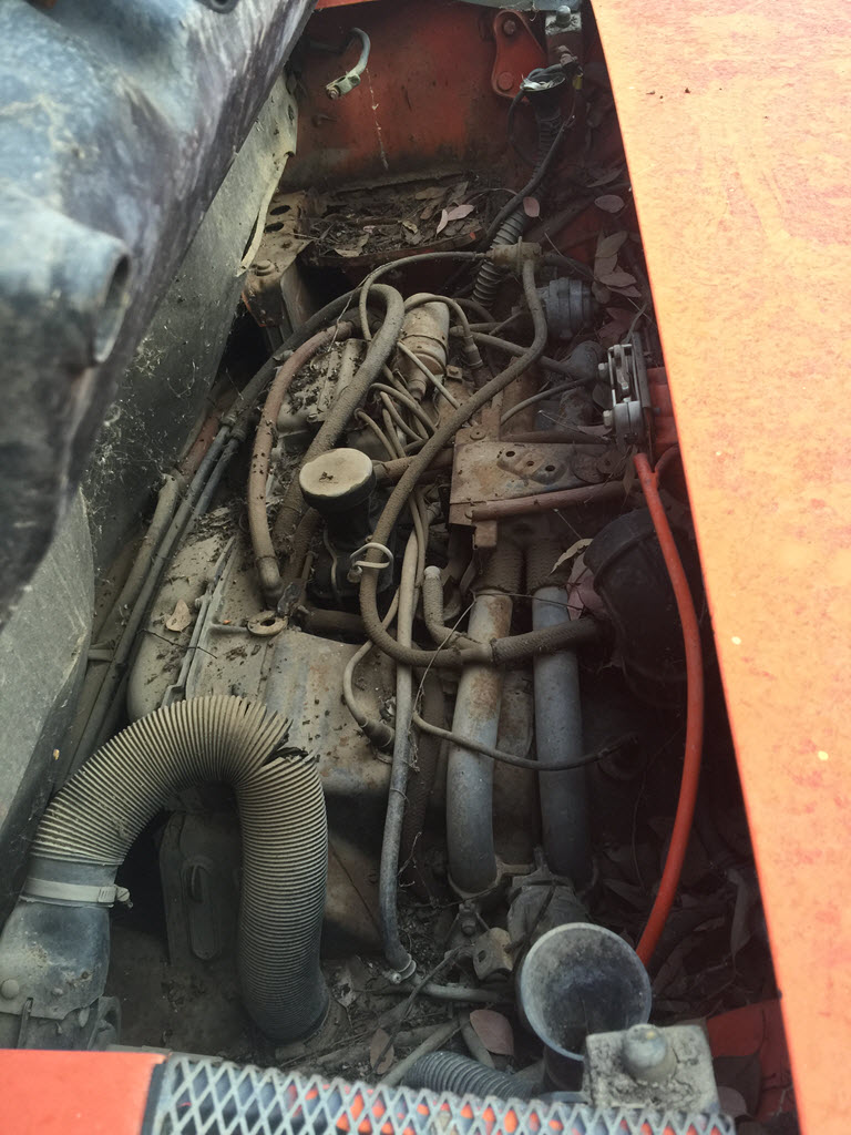

Jumping back into the 914 scene, got a lead on a 1 owner signal orange 73 - 1.7 that has been sitting outside in Central Valley California uncovered for about 20 years ("ran when parked"). Went and looked at the car yesterday, little surface rust on the battery tray, no visible rust under it, passenger long has no visible rust. Seems complete but obviously weather beaten. He only wants a couple hundred dollars so I'm not going to pass it up. Looking for a checklist of absolute musts to attempt to get the car started
Must;
- Remove fuel tank, clean and check for rust
- replace all fuel lines and filter
- replace injector seals
- soak injectors? in what?
- change oil with what type?
- clean all contact on relay board and fuse panel
What else?
Anyone point me to some threads of those that have done this before? I've searched for "resurrect" "revive" "sitting outside" no good hits.
Thanks!
-Luke

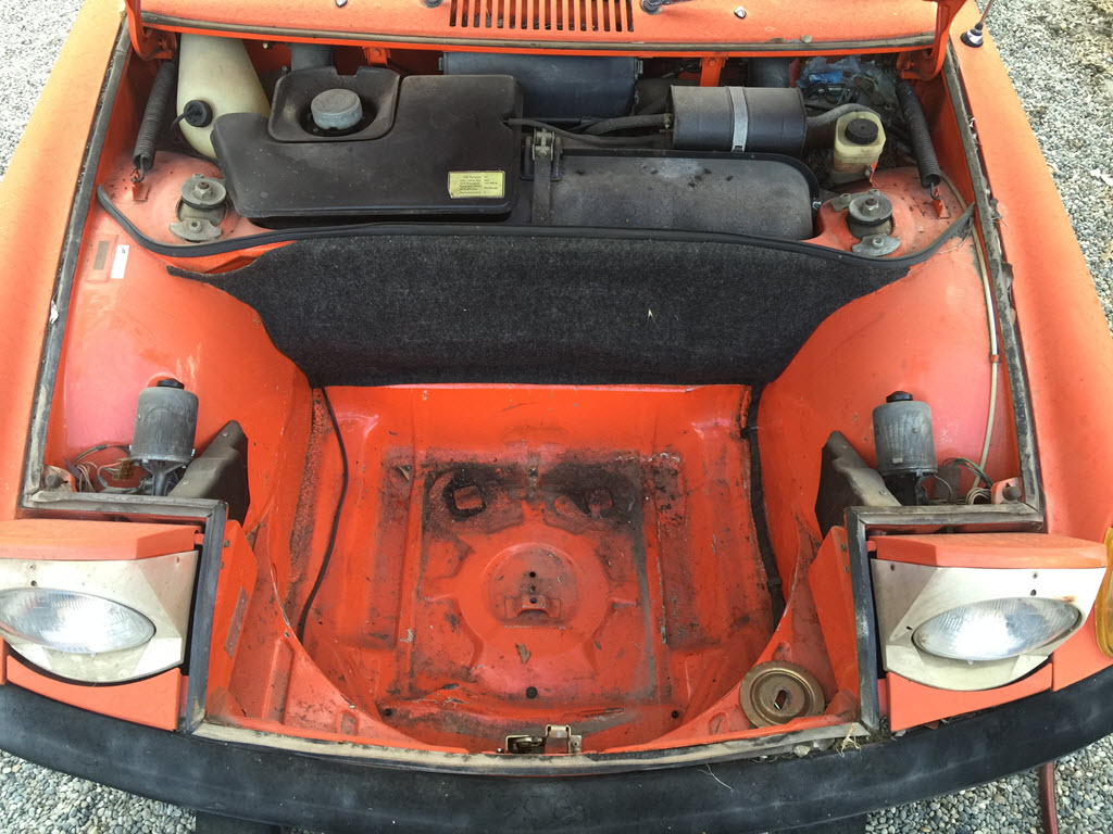

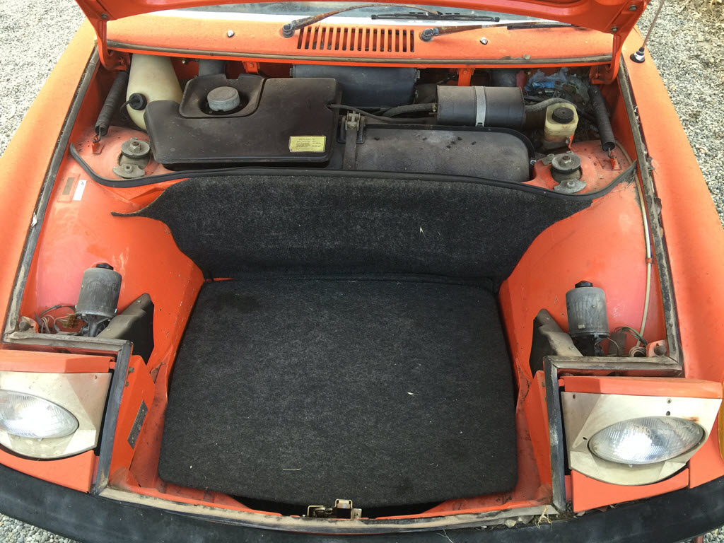

front trunk and engine
rear trunk is locked so I dropped off the front trunk tumbler at a locksmith, the key is ready to pickup so when I get home I hope to find some golden eagles from the same time period to pay for all the work this is gonna need (IMG:style_emoticons/default/smile.gif)

malcolm2   Brakes: hoses, calipers and the MC.....! And l...   Jun 9 2015, 09:28 AM
SirAndy   And let's see it. Sounds like a good find. ...   Jun 9 2015, 09:53 AM
LukeD   Brakes: hoses, calipers and the MC.....! And ...   Jun 9 2015, 10:05 AM
Hank914   Brakes: hoses, calipers and the MC.....! And...   Jun 9 2015, 12:28 PM
brant   tires too   Jun 9 2015, 09:55 AM
74ravenna   Vacuum hoses. Steve   Jun 9 2015, 10:05 AM
stugray   After some of the pictures I have seen recently ab...   Jun 9 2015, 10:28 AM
Claus Graf   This is what I did to get my 1974 914 1.8 started:...   Jun 9 2015, 11:57 AM
74ravenna   Hey Claus, How long had it been since your 1.8 la...   Jun 9 2015, 12:42 PM
JRust   Sounds like a solid project. Rust is always the bi...   Jun 9 2015, 12:52 PM

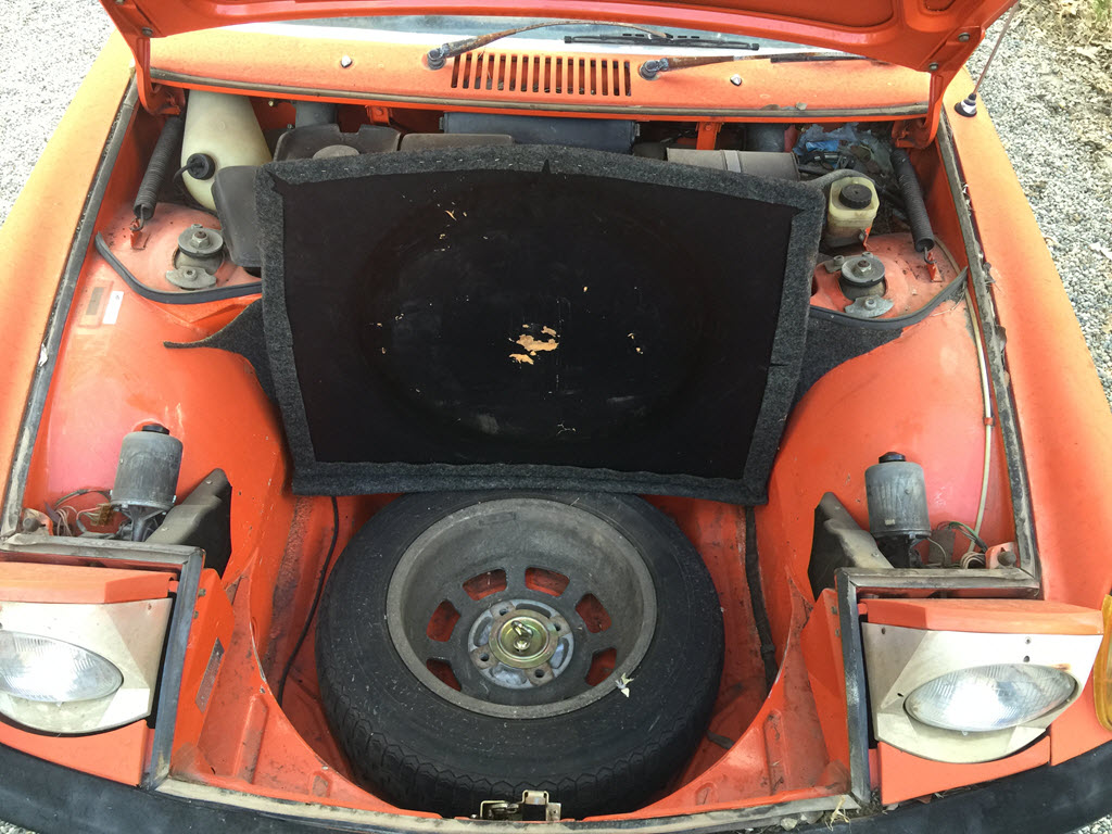

LukeD   safe at home, just needs new tires, fresh gas and ...   Jun 9 2015, 08:55 PM
Chris H.   Right. In fact that tire can probably be fixed...   Jun 9 2015, 09:10 PM

LukeD   front trunk and engine rear trunk is locked so I ...   Jun 10 2015, 12:00 PM
