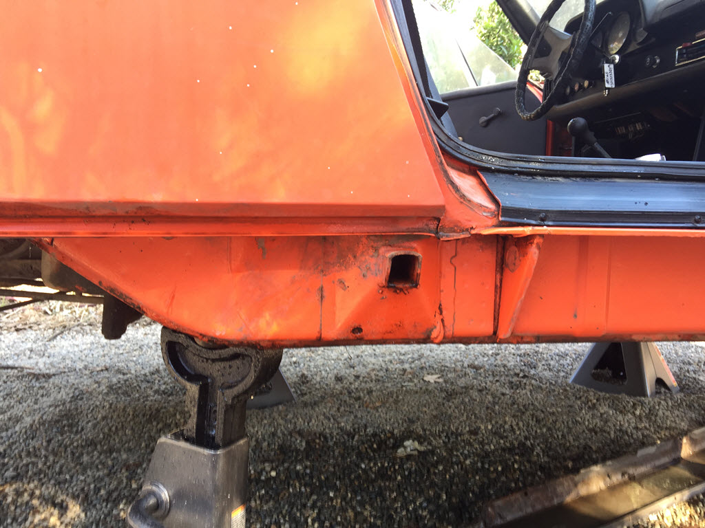

Jumping back into the 914 scene, got a lead on a 1 owner signal orange 73 - 1.7 that has been sitting outside in Central Valley California uncovered for about 20 years ("ran when parked"). Went and looked at the car yesterday, little surface rust on the battery tray, no visible rust under it, passenger long has no visible rust. Seems complete but obviously weather beaten. He only wants a couple hundred dollars so I'm not going to pass it up. Looking for a checklist of absolute musts to attempt to get the car started

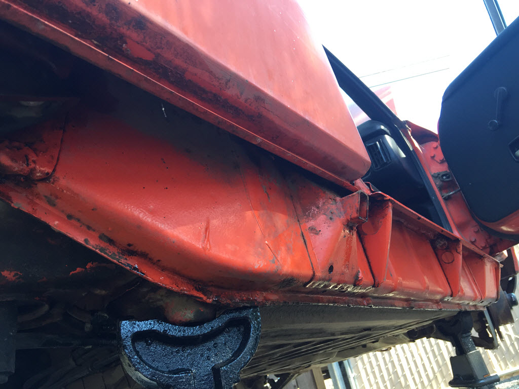

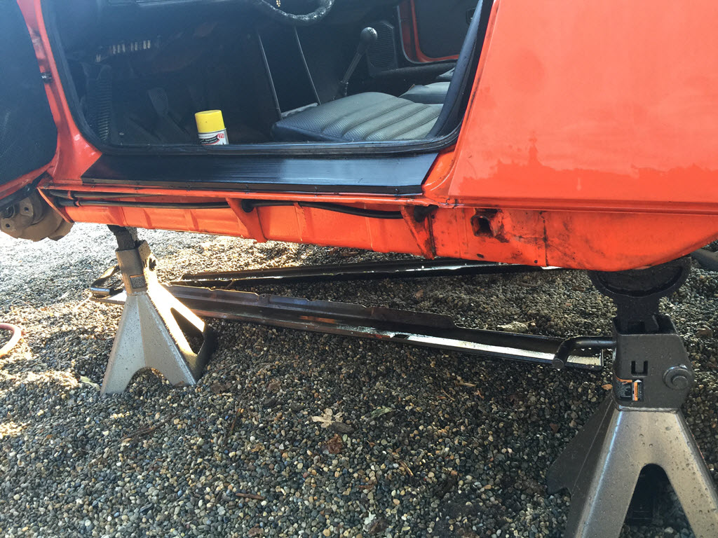

But I did get the rocker panels off, had to drill out the rivets and muscle the lower screws that were a bit rusty. Both sides were full of dirt but cleaned up nicely. Hoping the hell hole is in similar condition

LukeD   Passenger front and rear brakes, driver side looks...   Jun 12 2015, 11:25 AM
KELTY360   Passenger front and rear brakes, driver side look...   Jun 12 2015, 11:37 AM
billh1963   Those longs look great... :beer1:   Jun 12 2015, 12:01 PM
