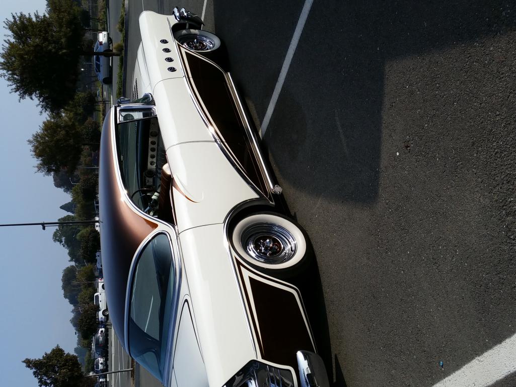

Looks like the candy brown on my 55 buick kustom. It's for sale if anyone is interested.

whitetwinturbo   Erik, Here's more another shade of "coppe...   Jun 12 2015, 10:13 AM
LeftCoastErik   Looks like the candy brown on my 55 buick kustom. ...   Jun 12 2015, 11:17 AM
whitetwinturbo   Nice paint job!   Jun 12 2015, 11:41 AM
LeftCoastErik   Thanks! It'd be nice if pics would post co...   Jun 12 2015, 11:48 AM
