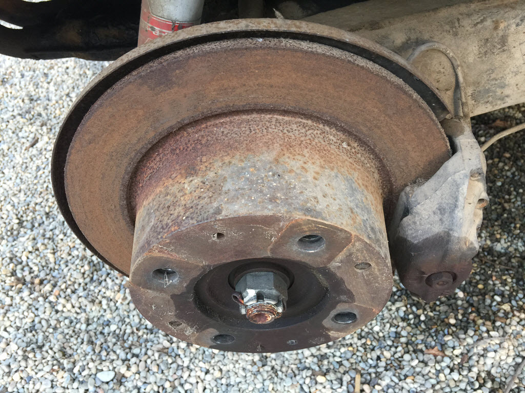

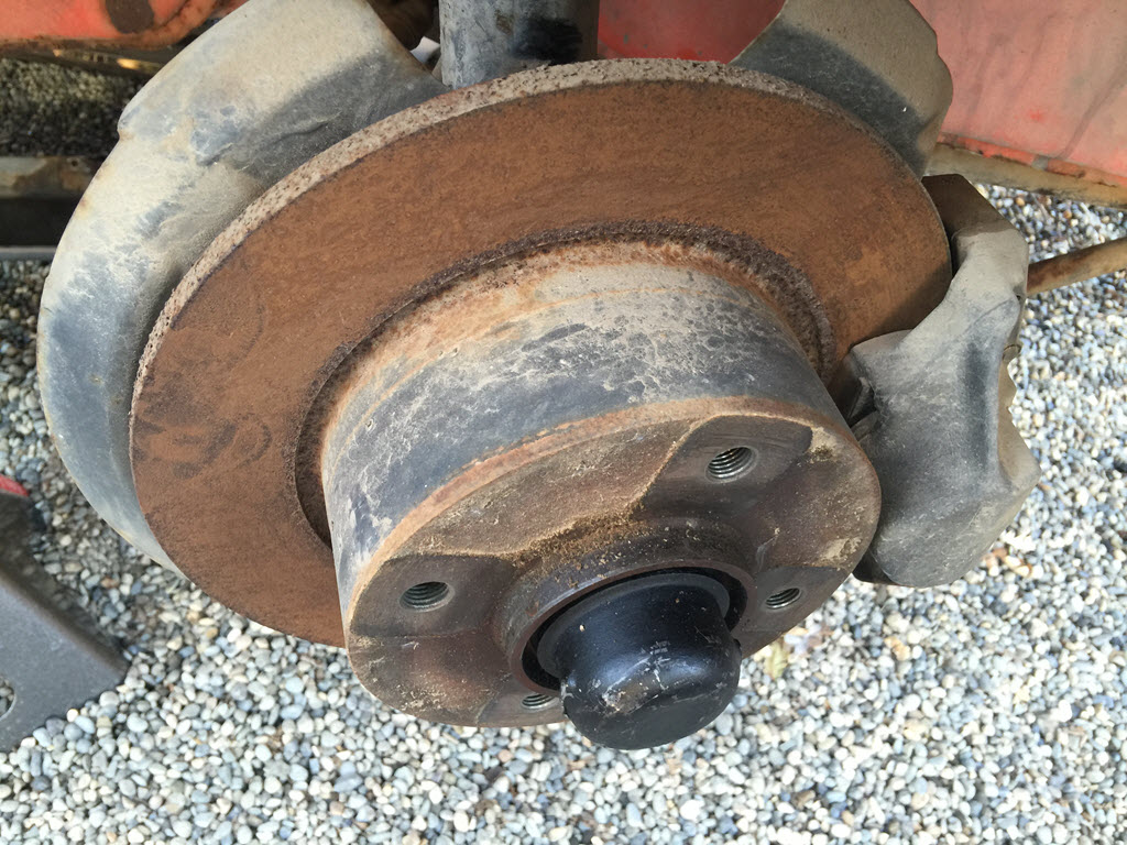

Passenger front and rear brakes, driver side looks the same
I'll be ordering rebuild kits and rubber lines from PMBPerformance and then flush the system.
Should I attempt to save the rotors and have them lightly turned or just replace?
