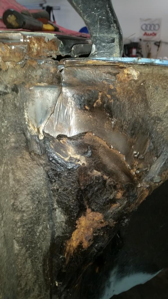

I then moved on to the front of the car and discovered some more exciting BS...I suppose that its totally OK to graft on a new (used) front end and then stop welding when you can't see or reach an area, right? I mean, I know its a unibody car, but I am sure some fiberglass resin will be strong enough to maintain integrity, right?
So, yes, I started yelling and throwing myself around for a minute...then I got back to work.

LeftCoastErik   I then moved on to the front of the car and discov...   Jun 15 2015, 10:47 AM
LeftCoastErik   Here's the drivers side...some of the spot wel...   Jun 15 2015, 10:49 AM
LeftCoastErik   I got everything seam welded up and then made new ...   Jun 15 2015, 11:27 AM
LeftCoastErik   I still have some work to do in the exposed corner...   Jun 15 2015, 11:36 AM
