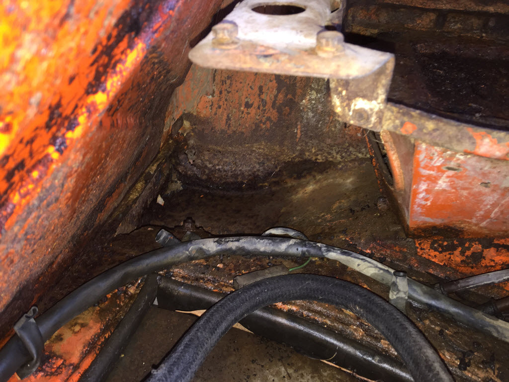

LukeD
post Jun 15 2015, 11:04 AM
Posts: 254
Joined: 14-November 04
From: Atascadero, CA
Member No.: 3,117
QUOTE(francar @ Jun 10 2015, 03:05 PM) *
It's rusty under there (can't have everything right?), I really poked around and made a few holes, I guess once I have the engine out I'll determine if I want to cut away the areas and weld in new (famous last words)

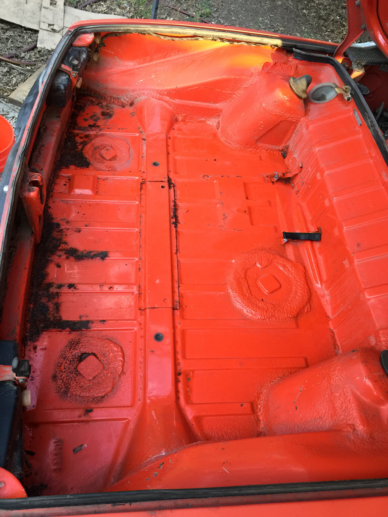

Rear trunk is crusty also, although I couldn't make any holes with a screw driver
