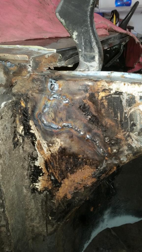

I got everything seam welded up and then made new patch pieces to actually connect the cowl to the inner fender

LeftCoastErik   I had a busy weekend of exciting rust bucket work....   Jun 15 2015, 10:36 AM
LeftCoastErik   more   Jun 15 2015, 10:38 AM
LeftCoastErik   I then moved on to the front of the car and discov...   Jun 15 2015, 10:47 AM
LeftCoastErik   Here's the drivers side...some of the spot wel...   Jun 15 2015, 10:49 AM
LeftCoastErik   I got everything seam welded up and then made new ...   Jun 15 2015, 11:27 AM
LeftCoastErik   I still have some work to do in the exposed corner...   Jun 15 2015, 11:36 AM
whitetwinturbo   Eric, you are the "welding MAN"! :w...   Jun 15 2015, 11:36 AM
LeftCoastErik   I am on my second big bottle of gas, and this spoo...   Jun 15 2015, 11:37 AM
LeftCoastErik   I decided to take another welding brake Saturday a...   Jun 15 2015, 11:39 AM
whitetwinturbo   :wub:   Jun 15 2015, 11:42 AM
LeftCoastErik   Thanks, I figured that out, but its a pain in the ...   Jun 15 2015, 11:42 AM
