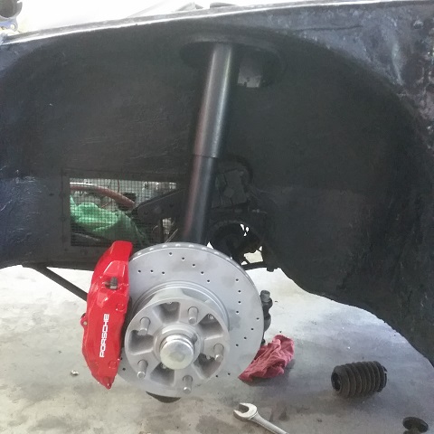

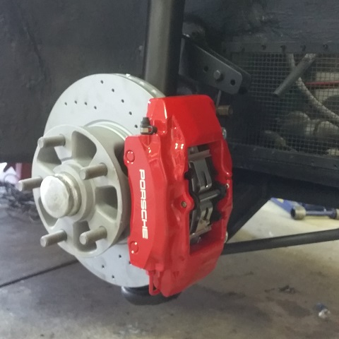

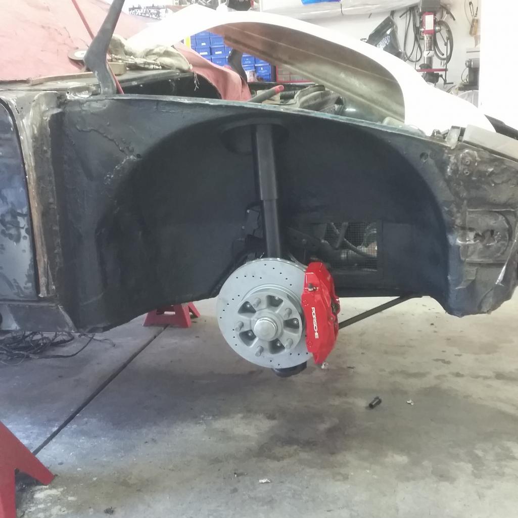

I decided to take another welding brake Saturday afternoon and got the front Koni struts, turbo tie-rods and brakes installed up front. Looking at that stuff almost makes all the BS worth it...Almost...
