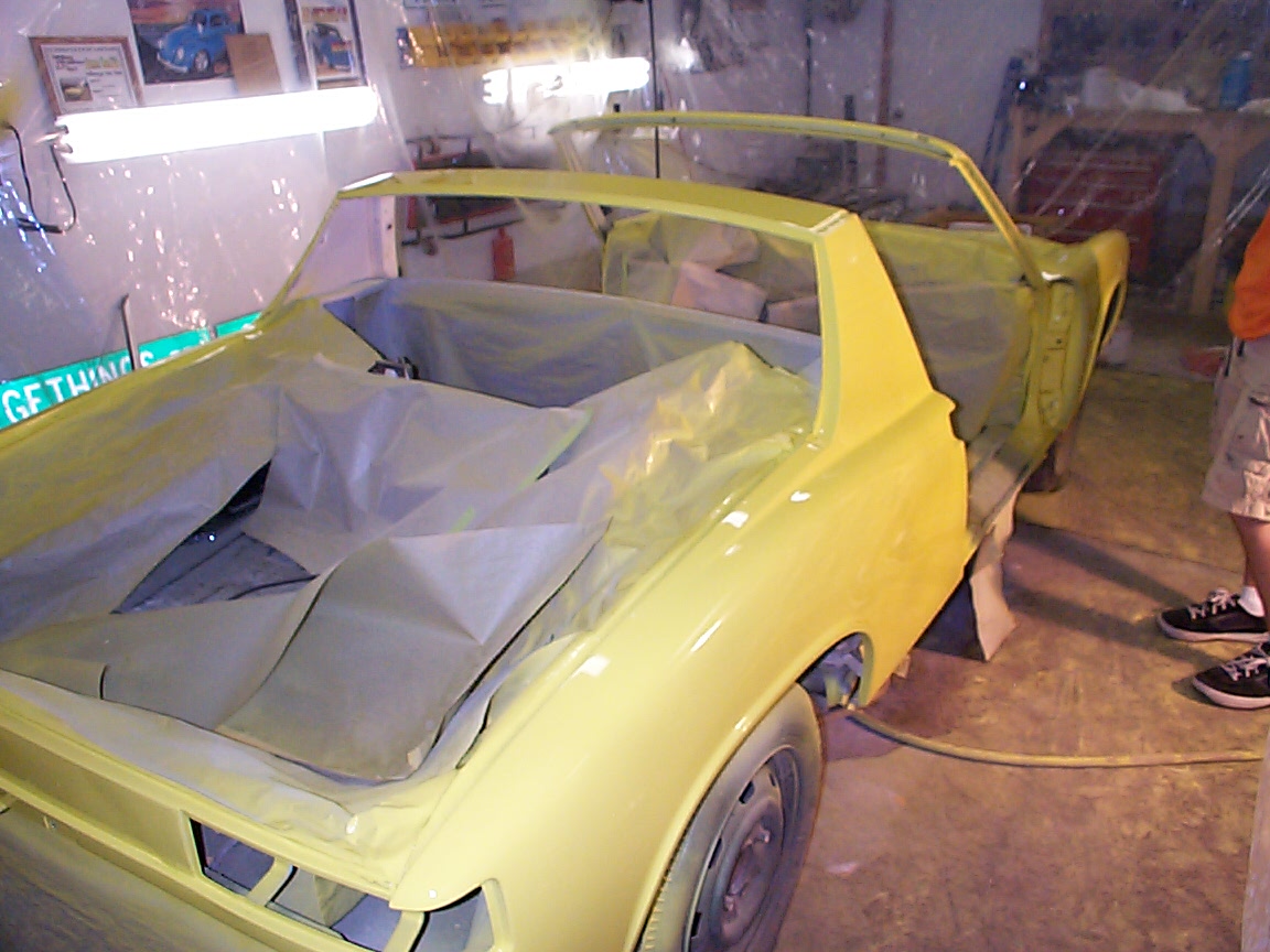

I took the afternoon off yesterday and painted the car. It turned out well, the color is Saturn Yellow, L13M. I made one major screw-up, let's see if you can find it. This car is slated for a 327-300 SBC conversion. Every time I paint I learn something. I am living proof that anyone can paint a car, 90% prep, 5% paint and 5% luck! Since I live in Michigan, any part that is covered, gets a coat or two of Por-15, that's why the door sills and firewall are not painted. The car was white!

Another pic, I pulled it out into the sun today, it looked totally different. I'll take a pic of that tomorrow.

Aaron Cox   rear fender?   Sep 9 2004, 08:04 AM
1bad914   Nope! Must be glare from my 5 year old 1.2 meg...   Sep 9 2004, 08:09 AM
Aaron Cox   did you mean not to do the door sill?   Sep 9 2004, 08:15 AM
BIGKAT_83   Your car looks great! Painting your car your...   Sep 9 2004, 08:18 AM
skline   Forgot to paint the inside of the roll bar. I did ...   Sep 9 2004, 08:24 AM
trekkor   You forgot to cover your tires and wheels... :lol2...   Sep 9 2004, 08:25 AM
morphenspectra   i have made this mistake b4 in painting a 914 you...   Sep 9 2004, 08:27 AM
1bad914   Skline you got it! :trophy: I did not realize ...   Sep 9 2004, 08:36 AM
jasons   Yeah thats a hard spot to get to also. You almost...   Sep 9 2004, 08:53 AM
1bad914   Hey Jason, at least you tried it! :trophy: Lo...   Sep 9 2004, 08:59 AM
jasons   Yeah, I went to Earl Scheib and acquired some free...   Sep 9 2004, 09:08 AM
