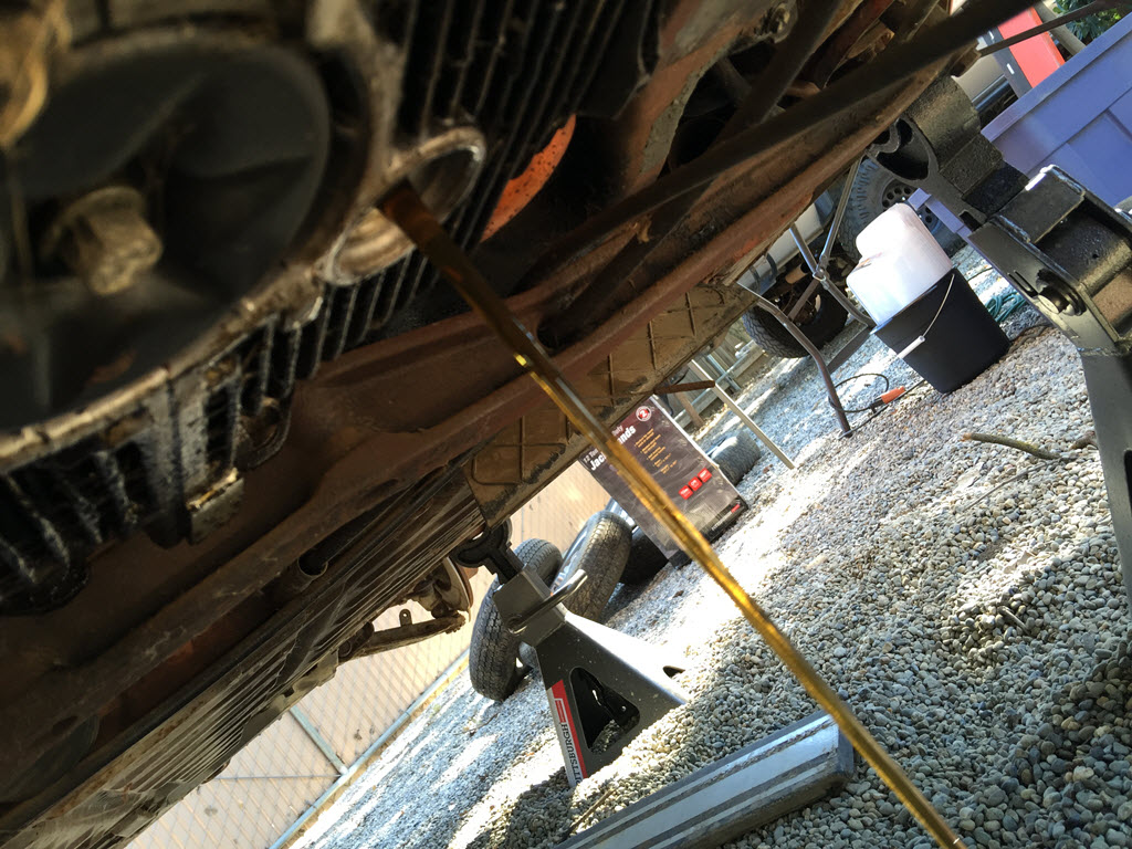

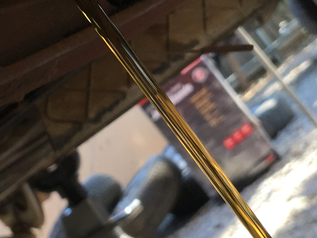

let the cylinders soak a couple days in some marvel mystery oil, changed the engine oil and filter
This doesn't look like 20+ year old oil but then again I haven't seen 20+ year old oil before

Phoenix914   That oil looks like it was never run.   Jun 16 2015, 10:41 PM

falcor75   That oil looks like it was never run. Exactly m...   Sep 17 2015, 11:11 PM
