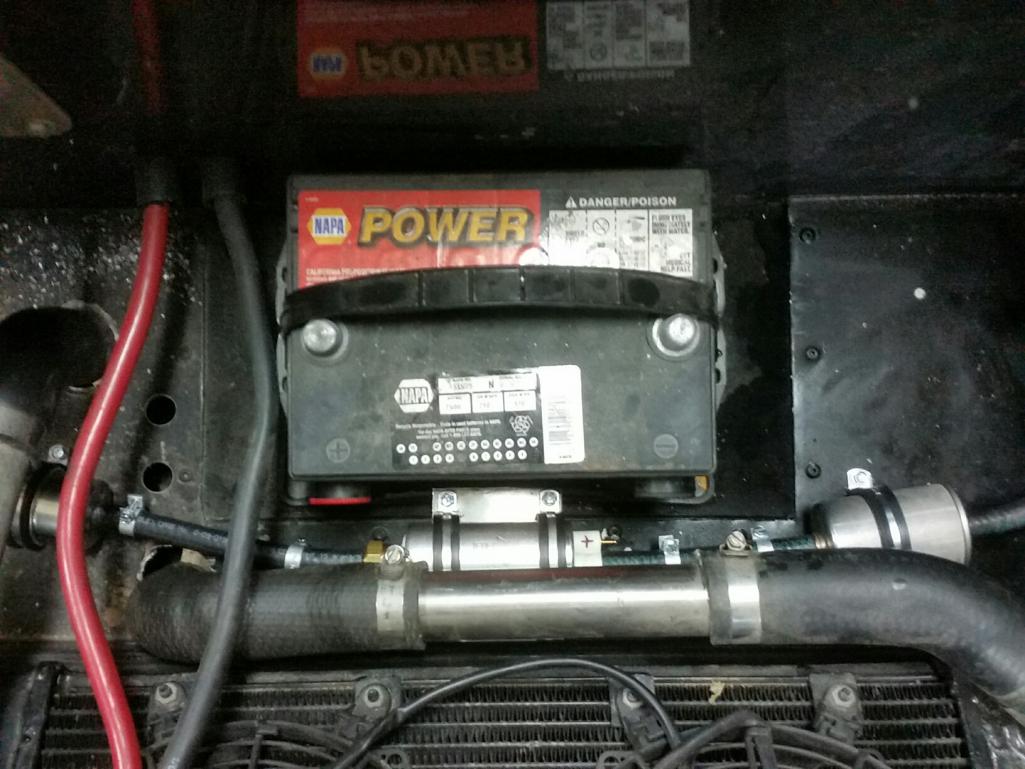

The past few days have been eventful. Got the fuel system installed, got the fuel tank back in the car. Got the Atomic EFI ECU, Coil, MSD 6a, Return Regulator and throttle body installed. Had to modify the firewall to clear the MSD Male-style cap (hooray).
I ran the feed and return lines through the driver's heater tube, along with the fan control wires and the fuel pump wiring. I actually used a measuring tape as a fish line and it worked pretty awesome.

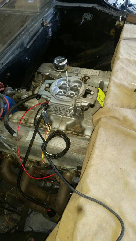

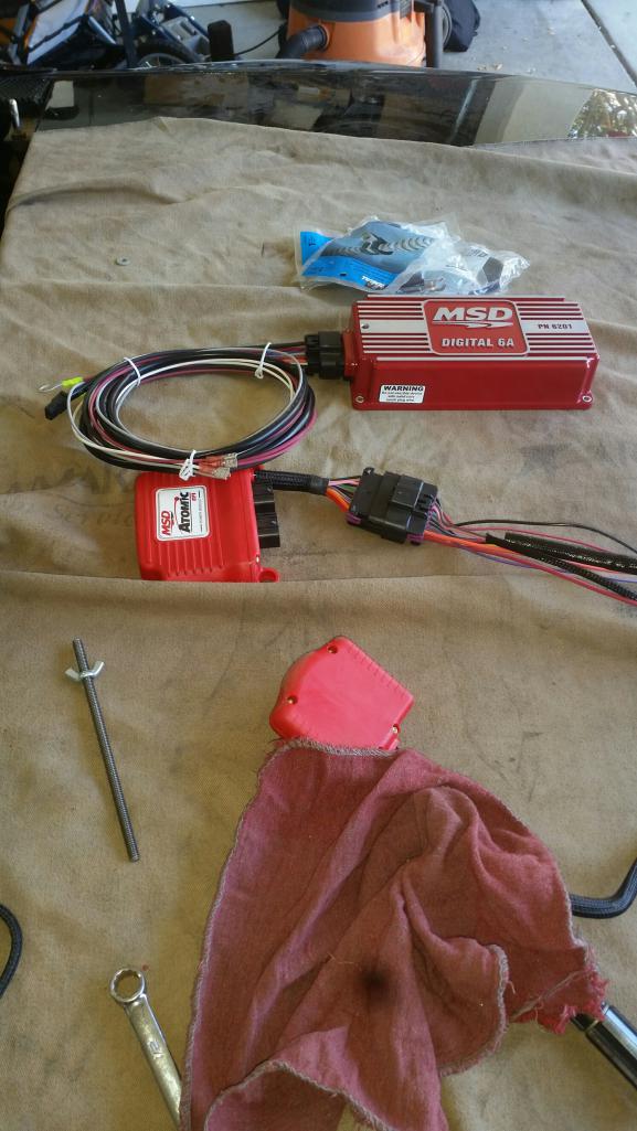

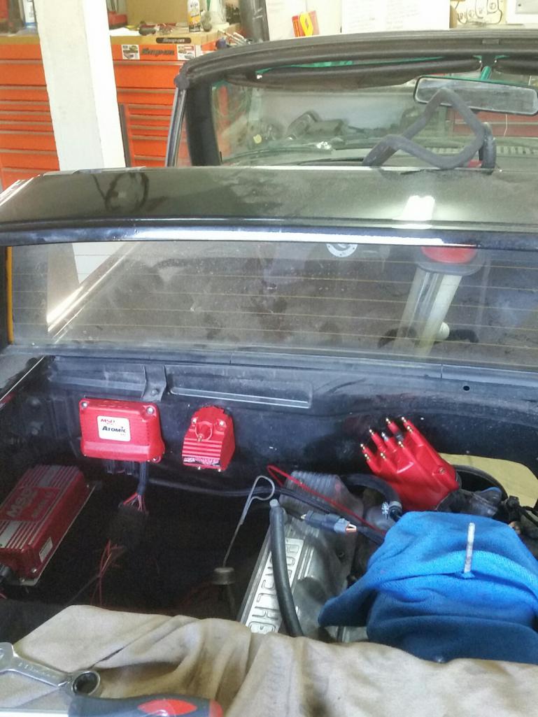

matthepcat   Sweet about the EFI. I want to hear how it goes, a...   Jun 2 2015, 06:52 PM
LeftCoastErik   I decided that the old, hammered relay board and a...   Jun 4 2015, 01:12 PM
