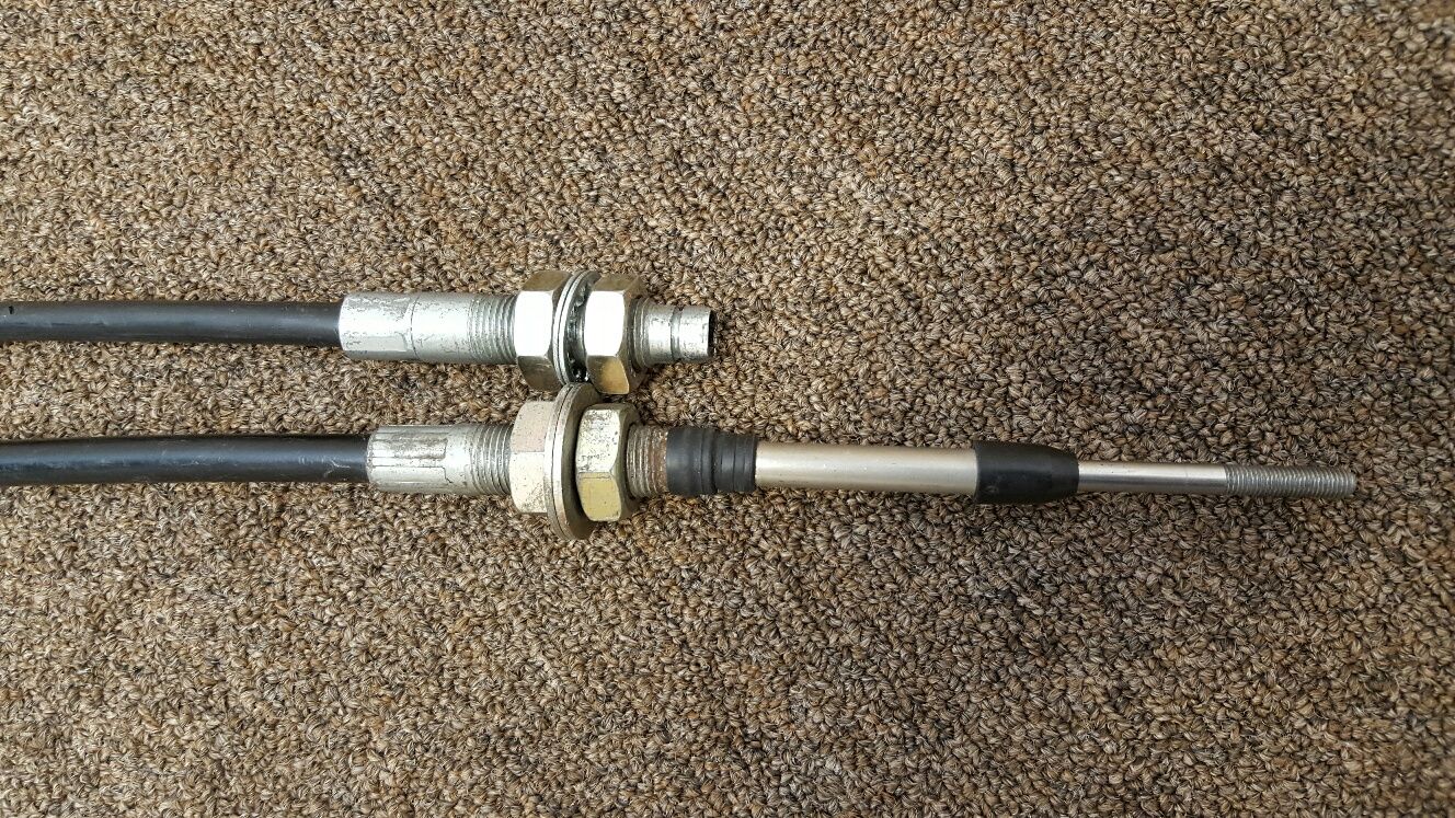

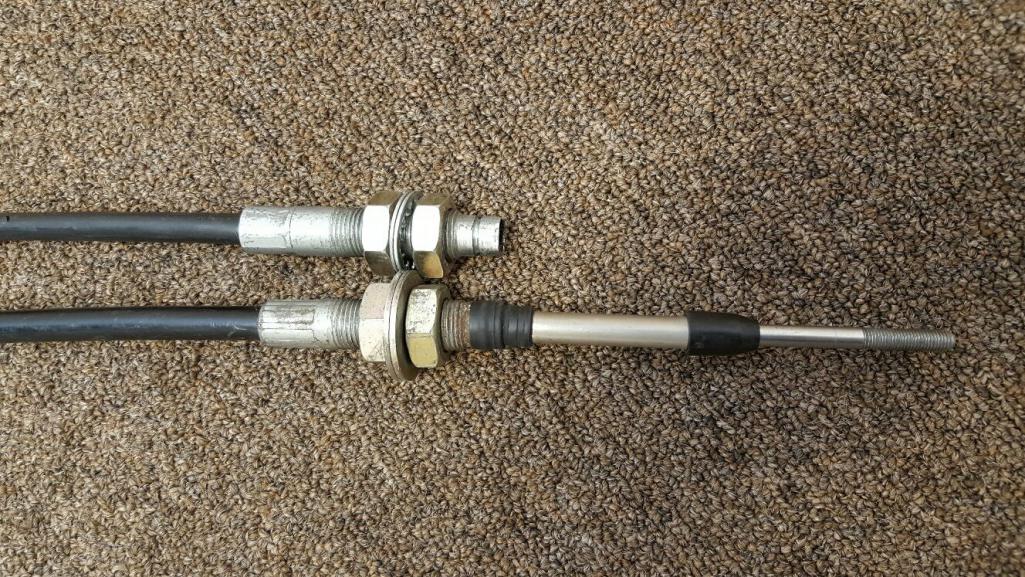

Okay so at WCR one of my shifter cables broke. After looking at multiple local auto parts & shops. Nobody does it around here or had a suggestion of where to go. I literally only need the cable itself with the ends crimped on. I did get a quote of $145 from the company that made my cables originally. Twice the price they were 3 years ago I might add. This is for a complete new cable. Which I really don't need the whole thing. Oh yes & there is a 6-8 week wait for this custom cable. In general they just pissed me off & I don't want to order from them. Nor wait 2 months to get it. Of course if I had ordered it right after WCR I would have it. I've had a lot going on & it wasn't high on my priority list (IMG:style_emoticons/default/dry.gif)
So I have some other cables from another setup. They are the same setup but about a foot shorter. So I would need to customize something in back to make it work. Is doable just not a 10 minute cable swap.
Ideally I just want a place that can make the cable insert I need. Really doesn't seem like there is nobody more local that can do that. So hoping for some ideas to point me where to look. I thought maybe a tractor supply place?
