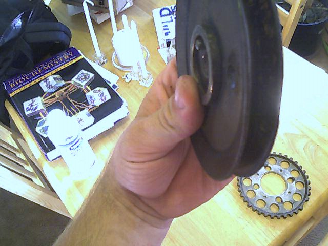

more...Side profile of the 911 pully, rear showing.

Dr Evil   Thanks, Mike. Thats real nice of you. Here are som...   Sep 10 2004, 06:53 PM
Dr Evil   more...Side profile of the 911 pully, rear showing...   Sep 10 2004, 06:53 PM
Dr Evil   close up of the wheel I got. It is much bigger tha...   Sep 10 2004, 06:56 PM
