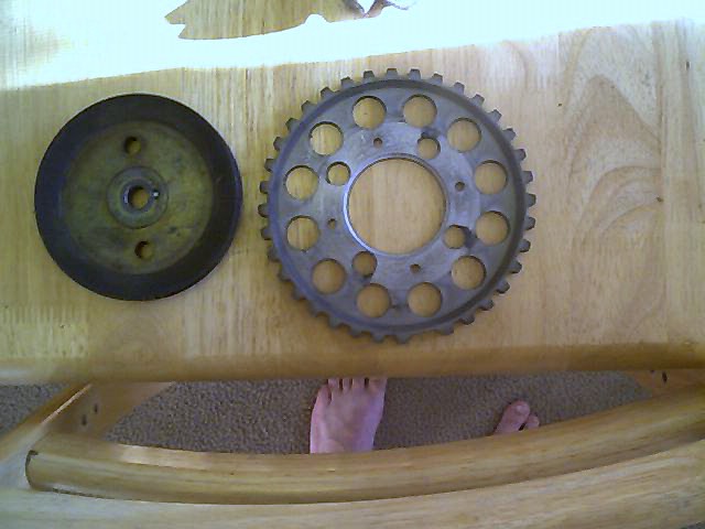

here is a comparison of the parts i took off of a car at the wreckers (ford escort) and the parts I found at NAPA auto parts
the bigger diameter wheel is a "wrecker" part and the sensor @ the 3:00 position is from the same car
smaller wheel and sensor just past the 1:00 position is are the new parts
obviously, the wheel will have to be modified to fit the /4 and a bracket will be needed for the sensor.
When I get back in a week from vacation, I will modify and mount the trigger wheel and make a bracket for the sensor....if there is any interest, I'll make a few extras for a small fee....currently I know I need to make at least 2 more, one for James Montebello and one for Jerry in Pleasanton (sorry cannot remeber your last name right now, (IMG:style_emoticons/default/wacko.gif) )
NAPA part numbers are:
CSS304 wheel
CSS411 sensor
now for the rest, you are on your own, hahahaha

close up of the wheel I got. It is much bigger than the pully, but I can get another if I need. Probably a 4cyl one would be smaller.
