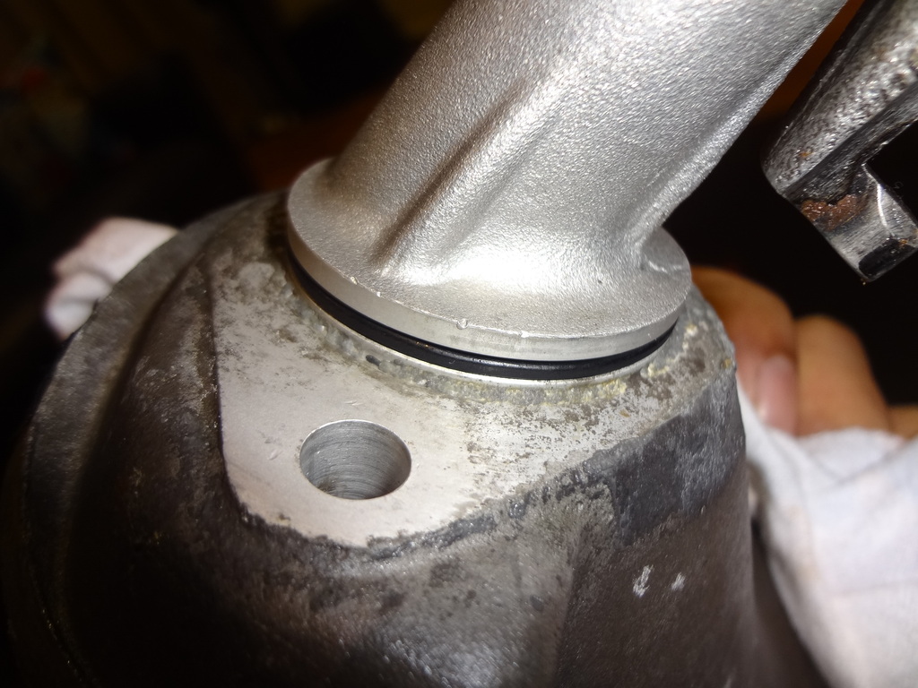

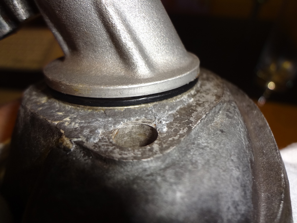

I bought some parts from Brad Mayeur to convert my tailshift to sideshift...
I have the engine and trans out and when I went to clean up the parts, I noticed that the area of the side shift console is a bit "corroded" just outside of the o ring area. So, for those that are familiar with these components, can i simply change the o-ring and install, or should I take it to a machine shop for careful milling? My little soda blaster was not able to shift any of the raised areas.... (IMG:http://www.914world.com/bbs2/uploads_offsite/i1260.photobucket.com-18462-1436179000.1.jpg) (IMG:http://www.914world.com/bbs2/uploads_offsite/i1260.photobucket.com-18462-1436179001.2.jpg) |

I would attempt a gasket scraper and wire brush. Either way it's not the sealing surface, so as long as the o-ring groove is clean, it should be OK.

914ltd The corrosion is not on a sealing surface, dress a... Jul 6 2015, 06:39 AM![]() ![]() |
