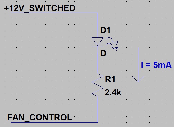

76-914   I wanted an "in use" indicator light in ...   Jul 5 2015, 09:36 PM
Tom   Kent, If you have a meter, check the resista...   Jul 6 2015, 03:01 AM
Spoke   Kent, If you have a meter, check the resist...   Jul 6 2015, 05:59 AM
76-914   Over my head. <_< What is "I" in...   Jul 6 2015, 08:53 AM
Spoke   I is current in the LED and resistor. Here's a...   Jul 6 2015, 10:41 AM
76-914   A million thank you's. :worship:   Jul 6 2015, 02:30 PM
