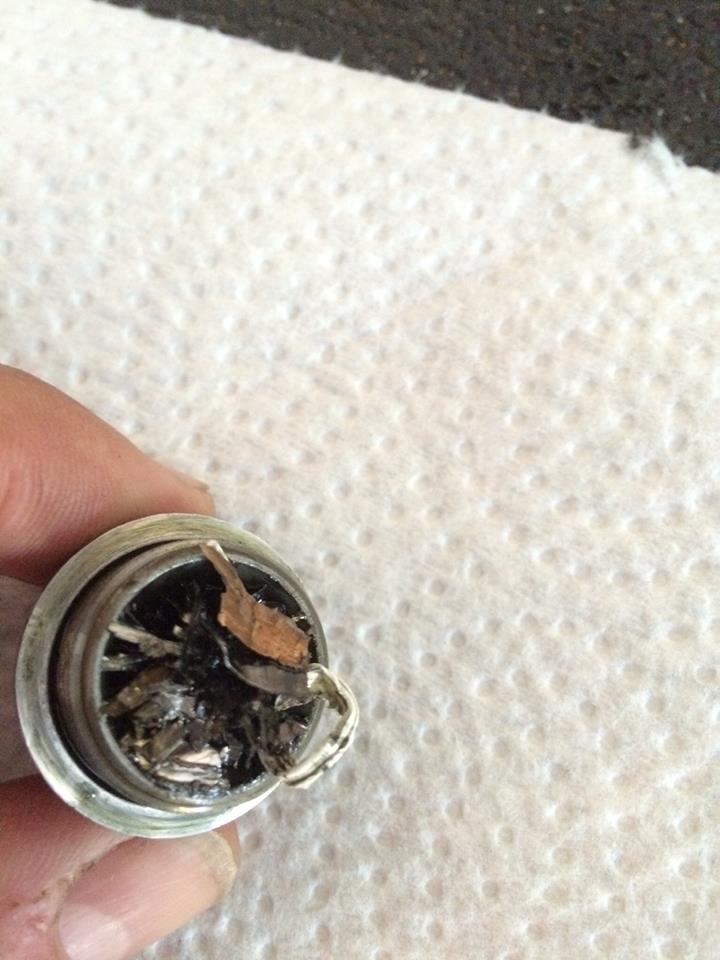

OH NO....NOT AGAIN!!!
So here we are, July 2015. To understand what has led up to this point, read Post #1. Let me add more detail on the shift rod issue I eluded to in Post #1 - the 2014 VIR weekend: As you can see, this was our first time back on track since Nov 2013. To recap, it was cold...really cold.. so we didn't do early runs. Later in the afternoon on Friday as I'm pulling out for one of my sessions, the axle bolts backed out and somehow got caught on the shift rod and bent/creased it!! Obviously they weren't tightened correctly by the guy that put the engine/trans in (though he denied it was his fault), but we lost a day and a half trying to fix the rod. In the end we each got a total of 3 sessions out of three days... March 2015 at CMP, the car runs well!! Woohoo!! Happy Day!! FINALLY we get a good weekend!!! March 2015 at the Road Atlanta Club Race...the new 915 transmission we had just put in expired after 15 minutes. This is a transmission that I had asked to have torn down and gone through because we knew nothing about it...but it was never done and we now had to suffer the consequences....3 more missed days on a race weekend... May 2015 at an SCCA TimeTrial - our first ever and something new and exciting especially for Nadine so she could do something competitive that's not wheel to wheel. After 5 laps, the crank pulley bolt backed out, shearing the dowel pin. We were done before Nadine ever got to drive.... The car had been at Exclusive Motorwerks since the transmission failure in March (actually, it's kinda lived there for 3 years now dealing with all the issues). Lou was supposed to prep it for the track. This bolt NEVER backs out if it's torqued correctly and has loctite on it. It wasn't and didn't. When I called Lou to tell him how upset we were, he asked "why do you always blame me for everything? Why is this MY fault? I'm sick of this f*&king car and sick of working on your cars" and he then hung up on me!! (IMG:style_emoticons/default/WTF.gif) So at that point, we were done, and we were finally moving on from his shop. I haven't spoken to him since. But unfortunately the story doesn't end there... I get the pulley fixed, new dowel pin, and reinstall it...all seems good. But 2 weeks later while prepping Papa Smurf for The Hawk vintage race at Road America, I start it up and hear an odd noise... uh oh... it sounded just like that noise back at the hillclimb in 2013. So I drain the oil and find this: ![]() Yes...what you see there is bearing material (brown piece is copper).. For the 5th time in less than 3 years, our engine is toast...again... The last 4+ years have been both so mentally and financially draining on us that we are to the point of giving it all up and being done with it all. We have spent an enormous amount of money, time and emotion into this, and have nothing to show for it. This is supposed to be fun, but we have been having anything but. We are tired of being upset, tired of being pissed off, tired of constant disappointment. Its started to affect our marriage, our relationship with others, and the way we view just about everything. I'm starting to feel like an angry old man...and I hate that!! I spent a week getting Huey race ready and transferring a lot of things out of Papa so we can do the Hawk race next weekend - only because it's all paid for and I can't get a refund - but I am very concerned because the engine was just rebuilt last year by the same guy. Huey is not a track car. I will tool around in the back and run at 7/10ths or less. I just hope we don't have two dead cars when we return. So this video, taken at the time trial, may be the last video we will have of Papa Smurf in a long time....I just don't know. For now, he's being stored away under a cover. Maybe next year things will change, but I really don't know. https://www.youtube.com/watch?v=k6EX9PI0r88 I'm sure many of you will read all this and scoff, saying 'such problems, boohoo', and I understand that. But we don't have kids, have worked hard for what we have, and the Porsche Club and track driving have been a major part of our lives and entertainment for most of our 24 years of marriage. Its something we do together, its our hobby, and when things are good, we have a great time and love it. But things haven't been 'good' for so long that we are questioning everything about it. All I ever wanted to do was be a race driver. I love it and its been a dream of mine since I was young to drive professionally. I'm too old for that dream to ever come true now, but doing amateur races and track weekends at least filled the thrill part. But we just can't go through the frustration and pain we've experienced the past few years any more. We will still do Hillclimbs and autocrosses with Huey (assuming he makes it through the Hawk), but it's just not the same. I'm not looking for sympathy, I'm just venting...I worked with Lou to help him get his business up and running, to get him out of a bunch of legal issues he was getting himself into, to renegotiate contracts so his equipment didn't get repossessed, I introduced him to lawyers and accountants to take care of him and his issues. I brought in a bunch of customers and helped him grow his business....all I was looking for was a car that ran reliably. Unfortunately, I was being too loyal to a 'friend' who obviously was in a bit over his head with our car. My bad... Why am I sharing all of this? I don't really know. Maybe because its the easiest way to share what's happening in our lives with so many friends and people that have helped us through the years. Maybe It's because I just want to vent my frustrations and detail how pissed off we are right now with a particular shop... Maybe because I'm mad at myself because I didn't see the obvious signs long ago and move on... I don't know... Thanks for reading.... |
