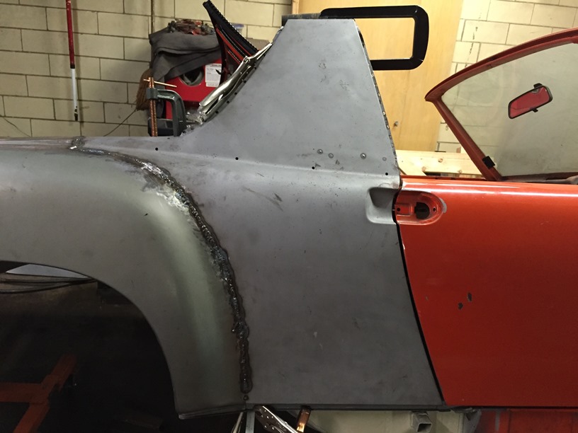

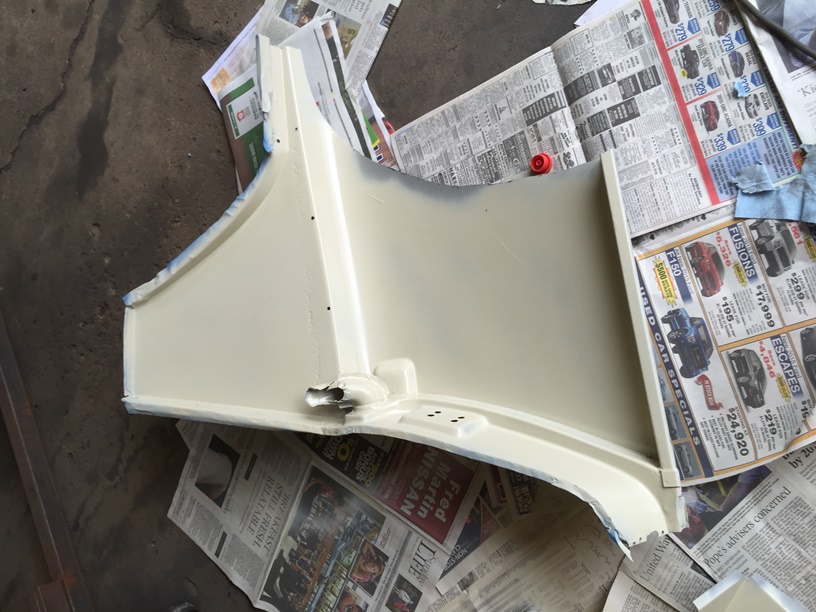

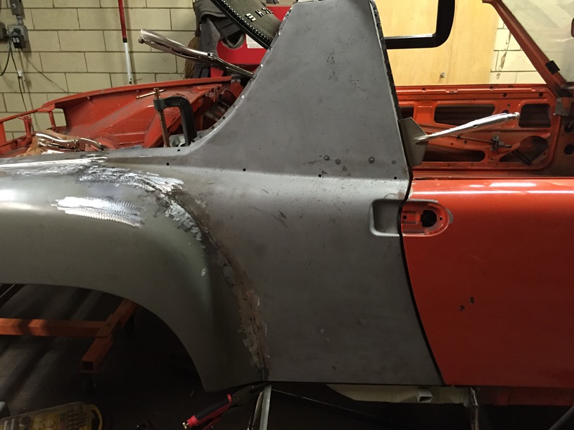

Moved to the front of the car and removed the front bumper support that was slightly bent most likely from a previous fender bender. Media blasted the surface rust and then applied epoxy primer then welded the bumper support back in.
Applied epoxy primer to the inside of the new fender section before spending many hours lining it up with the door gap and fender flare.
Thanks to everyone for their input on setting this gap. I finally welded the fender to the flare and finish ground the weld.
Still have to finish all the spot welds around the outside of the fender section.
Then the next step is to put the rear trunk back on and figure out where to locate the hinge support that is broken off. Not looking forward to this step for some reason.
