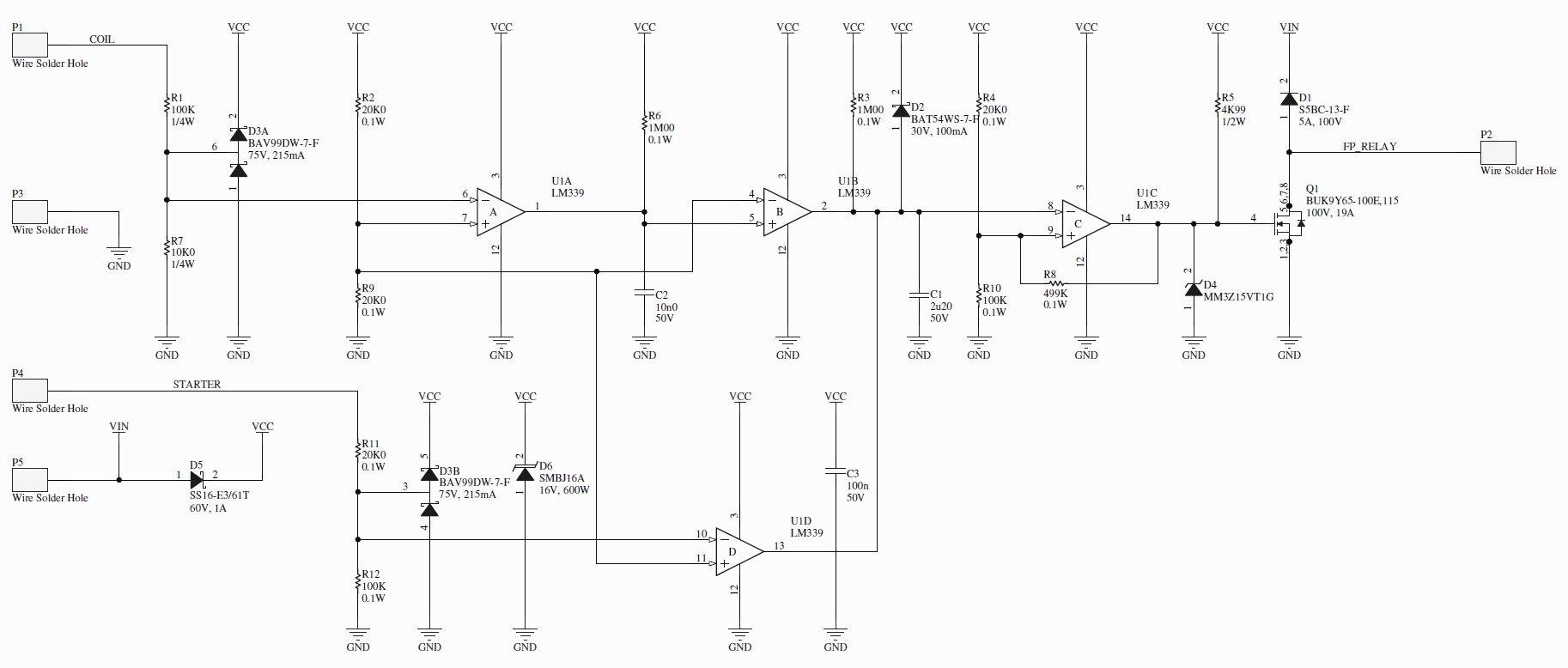

I'm designing a PCB to power the fuel pump like DJET systems do: Turn the key on and the fuel pump charges the system for 2 seconds then turns off. When the engine starts turning, the fuel pump will run.

Simplest would be to just have a RC circuit that is charged when the coil is firing, but self discharges.
Well, I ended up with an RC circuit. Actually 2 RC circuits. But it isn't very simple. (IMG:style_emoticons/default/biggrin.gif)
I thought I had a circuit that works then I simulated the circuit with LTspice and it failed miserably. This is 2nd circuit and it seems to work. (IMG:style_emoticons/default/beerchug.gif)
Whatever ICs I used I want them to be 25V+ tolerant so I don't have to create a lower voltage. So I focused on using comparators. The main timing is C1 and R3. This is a 2 second delay used for key-on and after the engine dies.
Comparator U1D senses when the starter is engaged and shorts C1 to ground turning on Relay driver Q1.
