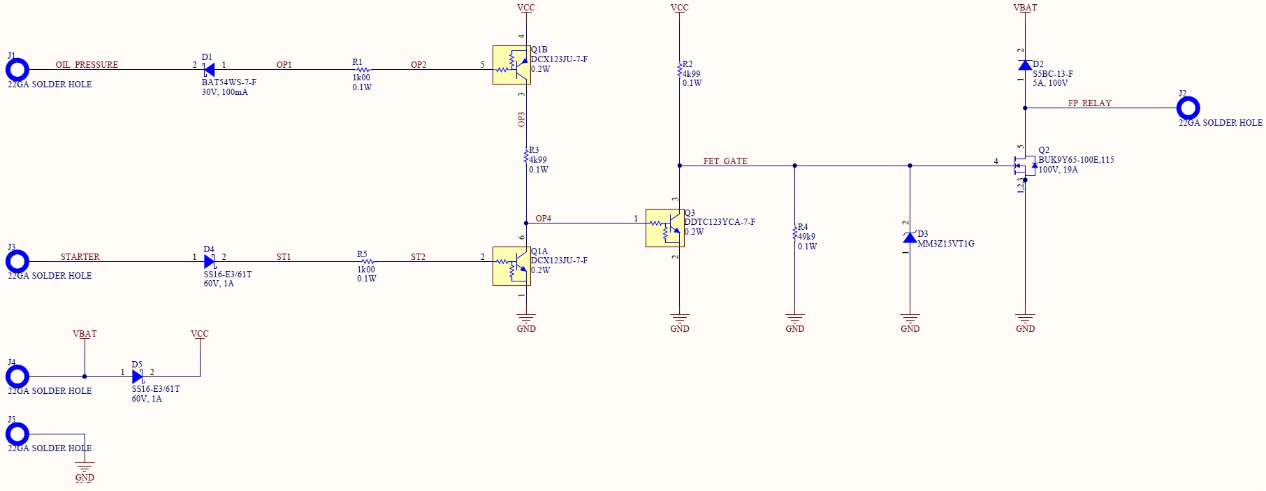

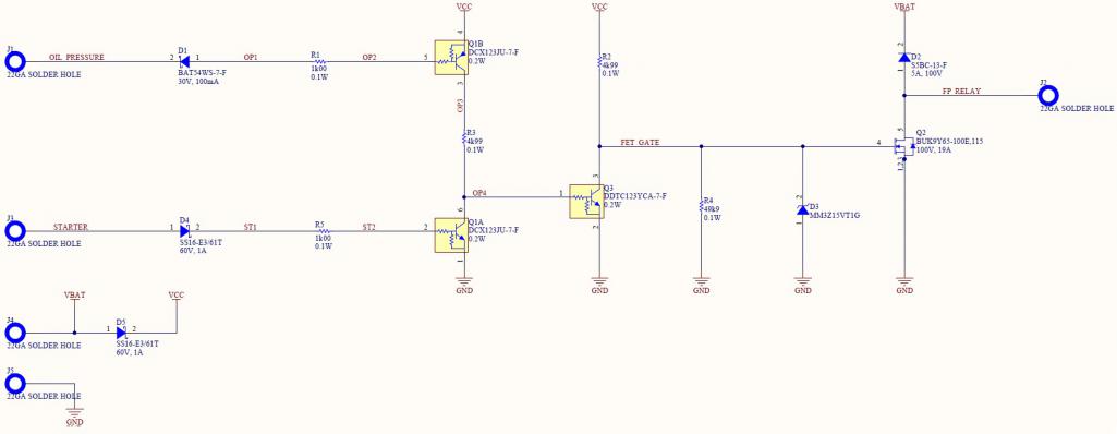

Here's a simpler circuit which interfaces to the oil pressure switch to sense engine running. I think I'll add an LED to indicate the pump is powered.

Spoke   Here's a simpler circuit which interfaces to t...   Jul 19 2015, 04:17 PM
Spoke   Here's the layout of the oil pressure fuel-pum...   Jul 19 2015, 09:51 PM
