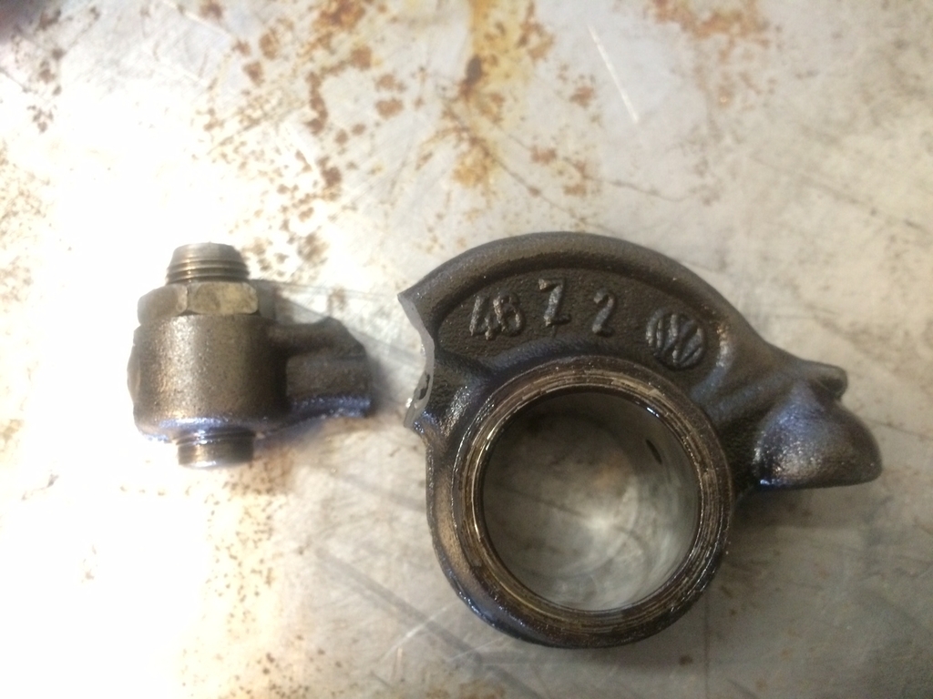

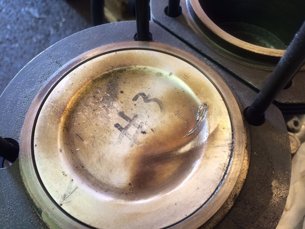

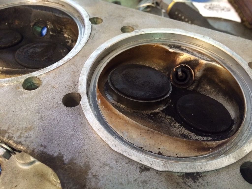

I pulled the head for #3/4 this afternoon and got more bad news. The intake valve seat on #3 had dropped. The piston has hit the intake valve and broken the rocker arm.
(IMG:http://www.914world.com/bbs2/uploads_offsite/i1300.photobucket.com-17452-1437407864.1.jpg)
(IMG:http://www.914world.com/bbs2/uploads_offsite/i1300.photobucket.com-17452-1437407864.2.jpg)
(IMG:http://www.914world.com/bbs2/uploads_offsite/i1300.photobucket.com-17452-1437407864.3.jpg)
I found a Rocker arm for a type IV it has the same part # can anyone say if its the correct part for a 2.0 76?
Help much appreciated as I am beginning to get a little disheartened

Cj Honeycutt   Crap ! In this case, the push rod is almost fo...   Jul 20 2015, 10:37 AM
Valy   When did you last adjust the valves? Did you have ...   Jul 20 2015, 11:53 AM
DavidSweden   When did you last adjust the valves? Did you have...   Jul 20 2015, 12:06 PM
stugray   Perhaps the rocker failure and the seat failure ...   Jul 20 2015, 05:34 PM
DavidSweden   Perhaps the rocker failure and the seat failure...   Jul 21 2015, 02:20 AM
