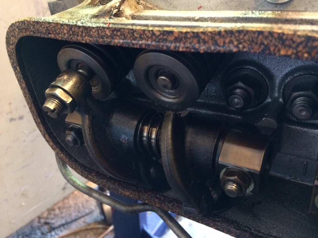

Can you push open the valves that broke/bent the valve train?

QUOTE(Valy @ Jul 20 2015, 12:58 PM) *
When you say push open do you mean by hand or with the use of a tool?
Heres what it looked like when I removed the valve cover, to quote another member "people like carnage"
(IMG:http://www.914world.com/bbs2/uploads_offsite/i1300.photobucket.com-17452-1437426856.1.jpg)

DavidSweden   I pulled the head for #3/4 this afternoon and got...   Jul 20 2015, 09:57 AM
Cj Honeycutt   Crap ! In this case, the push rod is almost fo...   Jul 20 2015, 10:37 AM
Valy   When did you last adjust the valves? Did you have ...   Jul 20 2015, 11:53 AM
DavidSweden   When did you last adjust the valves? Did you have...   Jul 20 2015, 12:06 PM
stugray   Perhaps the rocker failure and the seat failure ...   Jul 20 2015, 05:34 PM

Valy   Can you push open the valves that broke/bent the v...   Jul 20 2015, 02:58 PM
DavidSweden   Can you push open the valves that broke/bent the ...   Jul 20 2015, 03:14 PM
