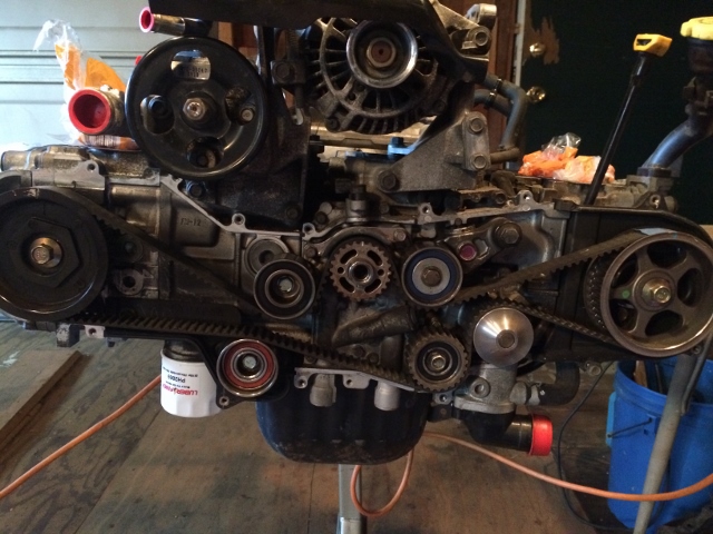

The original 1.7 has been sitting for at least a decade. It ran before it sat... sound familiar. I decided that it was not worth it to rebuild the 1.7, but to go the suby route.

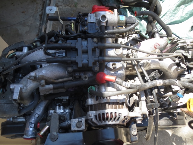

All the parts you see came from the same Subaru Impreza TS (2003). I got the ECU, engine, tranny from the same car. I am replacing the head gaskets, clutch, water pump and timing belt.
SOHC NA - No Turbo, 2.5 litre, 165 HP, 164 Torque
Engine Work Videos
Subaru Engine Build Series Ratchets and Wrenches
Timing Belt Removal / Timing Belt Replacement (Timing marks at 3:50)
https://www.youtube.com/watch?v=27egytbdxUQ
https://www.youtube.com/watch?v=rgTQGko3SZM

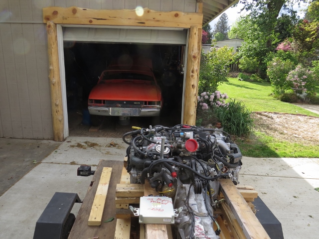

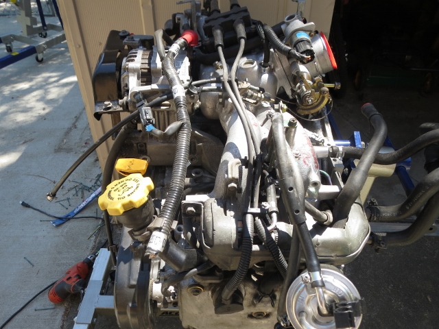

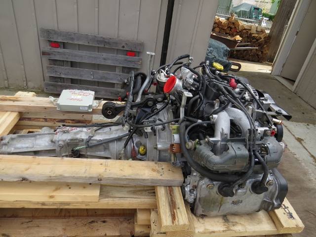

Here's the engine- arrived from Canada in April of 2015- See Christmas in April thread.
(IMG:http://www.914world.com/bbs2/uploads_offsite/i1301.photobucket.com-17072-1438236672.3.jpg)
(IMG:http://www.914world.com/bbs2/uploads_offsite/i1301.photobucket.com-17072-1438236672.4.jpg)
(IMG:http://www.914world.com/bbs2/uploads_offsite/i1301.photobucket.com-17072-1438236672.5.jpg)
(IMG:http://www.914world.com/bbs2/uploads_offsite/i1301.photobucket.com-17072-1438236672.6.jpg)
(IMG:http://www.914world.com/bbs2/uploads_offsite/i1301.photobucket.com-17072-1438236672.7.jpg)

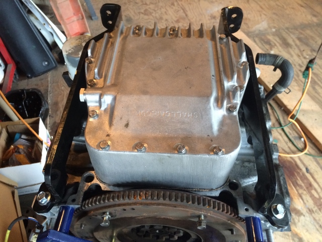

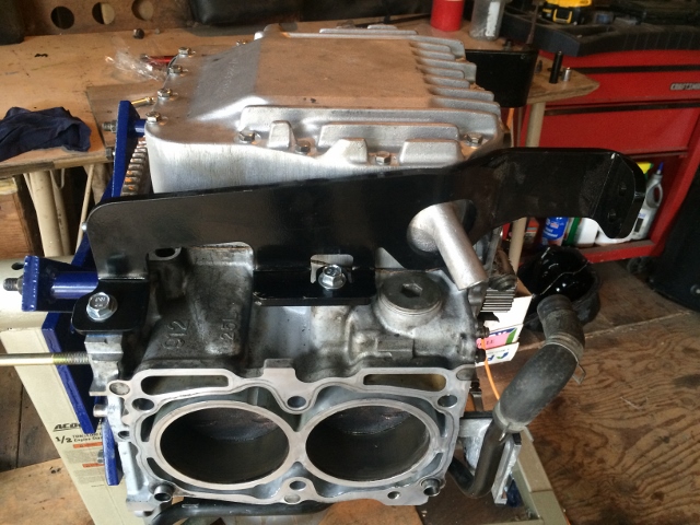

Small Car Performance oil pan is low profile yet increases oil capacity to 5 quarts. I like that it's flat and designed to be strong enough to support the engine in needed. Engine mount is also from Small Car. It will be welded up against the stock engine bracket/brace.
(IMG:http://www.914world.com/bbs2/uploads_offsite/i1301.photobucket.com-17072-1438236673.8.jpg)
Side view of the oil pan and engine mount. Notice the oil dipstick tube goes through the engine mount. Cool design.

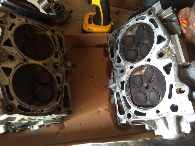

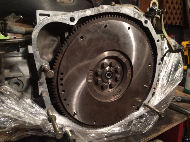

Shiny flywheel back from the machine shop. I had the same shop machine the heads, install the head gaskets and adjust the valves.
