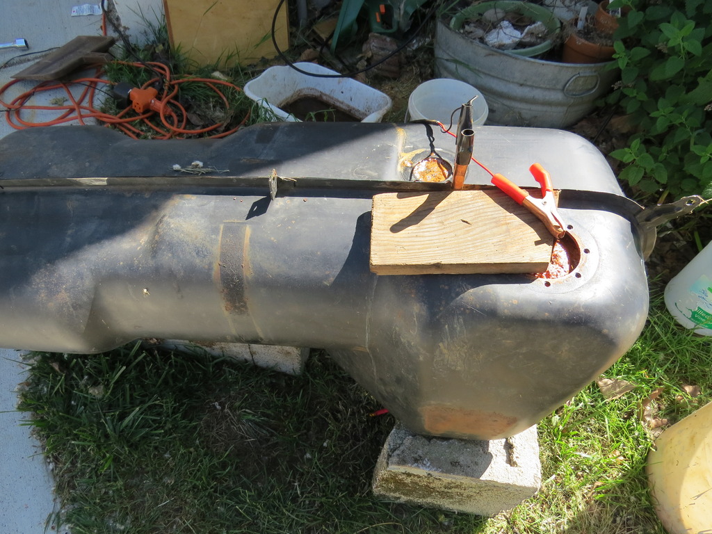

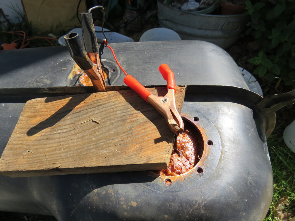

Electrolysis Gas Tank Cleaning.
Like so many other 914's mine had a rusty fuel tank. Cleaning the inside of the gas tank is tricky since you can't reach in and sand it, so after some research I tried lots of different suggestions to try to clean it. One could combine weight training with car antiquing and shake a chain or nails or whatever inside the tank. I tried acid ie apple vinegar. None of these things seemed to work until I came across electrolysis. This is a very interesting technique. Anyone who has tried precipitating silver in chemistry class might be familiar with this technique. You take a piece of steel and suspend it in water in your gas tank with some baking soda as catalyst and it moves the rust from your tank into the water. It's pulling electrons and iron from the metal and combining it with the rust metal to create a liquid suspended iron.
My stepfather, professor emeritus in chemistry at St. Mary's College in CA explains electrolysis thus:
"Some of us used it as an introduction to electrolysis in early classes – and I believe it is still used in museums as a conservation process to “clean” up relics to remove rust without losing the underlying metal."
"You first of all have to understand the rusting process. In overall terms it is simply, iron + water + oxygen -----~ rust. However, the first step is Fe (solid) + 2 water +1 oxygen -----~2 Fe(+2) + 4OH(-). Depending on the environment, additional reactions take place, leading to the observation that most forms of rust are basically 2Fe(+3)3O(-2).xwater; this is a hard material which binds to the unoxidized metal."
"Essentially what has happened overall is the removal of electrons from the iron; that is in chemical terms you have oxidized it. To remove the rust you can reduce it; that is, give the electrons back. These set-ups that you’re working with seem to work, but the exact mechanism isn’t clear. In your case the electrons will move from the anode Fe (i.e. the steel chunk) over to the tank which needs them to convert the Fe(+3) to Fe. The chemical reactions that occur during electrolyis are complicated since both iron oxides and water can be reduced (to hydrogen in the case of water), so specific reactions can’t be written but the appearance of bubbles is usually a sign of hydrogen. The iron from the steel chunks slowly disappears over a period of time as Fe is converted to Fe (+3) and the rust should flake off the cathode as a dusty material which probably has metallic iron mixed in. Make sure your anode (+) has a good connection to your steel chunk."
Links:
Lots of links and videos on this page.
Cleaning the tank. I used a trickle charger for a couple weeks, but it was only 2 amps of power. If I did this again I would get a battery charger and try different settings for a faster process, but I was not in a big hurry. This process works great for removing rust, especially with odd shaped pieces like the pedal cluster and gas tank.
